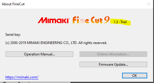

There is a very simple workaround I discovered when we accidentally broke the middle of our FC cd taking it out of the silly plastic container. Luckily I'd saved the contents long before, though.
But all you need to do is take a blank cd, and format it or burn it with the CD label being the word 'Finecut'
No contents or data is necessary- just the cd label.
The installation program will look for that 'original' cd, and once it finds it, then continue with the upgrade which is really a stand-alone program.
The problem you might have is finding the right version, if you are using specific older ones.Certain upgrades are for certain versions of Corel or of Windows. The wrong FC ones simply will not work.

You can download FC from the Mimaki site - there are umpteen different versions depending on whether you have Win7, 8, 10, and which version of Corel Draw or Illy you may be using.
There's no one-version-suits-all.
But getting it to work is the test.
The win 10 version needs extra windows files and I think generates its own release code. I'm sure I tried it and eventually got it going - except Win 10 does not work with Corel X3 which I prefer for plotting.
I had it going with X5 I think, & win 10 on a Dell, till the hard drive failed, and I went back to a Win 7 dedicated PC for the plotter, and a KVM switch.
You need to name a blank CD appropriately - I forget the name needed - I thought I'd replied to this a few years ago-or someone else had.
You'll also need the Mimaki USB 2.0 drivers downloaded, I think, and some other file - but that's for the plotter rather than for Finecut.
I ran a Ghost type program to make a HD image of the setup, once running.
Our original FC cd is cracked in the centre, sadly, from being removed badly from the case.
I think I also started with FC 7 and Win7 ,and loaded that, then upgraded to 8 with the upgrade.
I had a feeling with Win 10, the FC 7 would not work, and the CD labeled Finecut would not work - I had to name it something else that resembled FCWIN08 or similar mildly obvious codename. Then it generated its own unlock code eventually - took 3 attempts.
Hence I am happy with the Win7 version.
