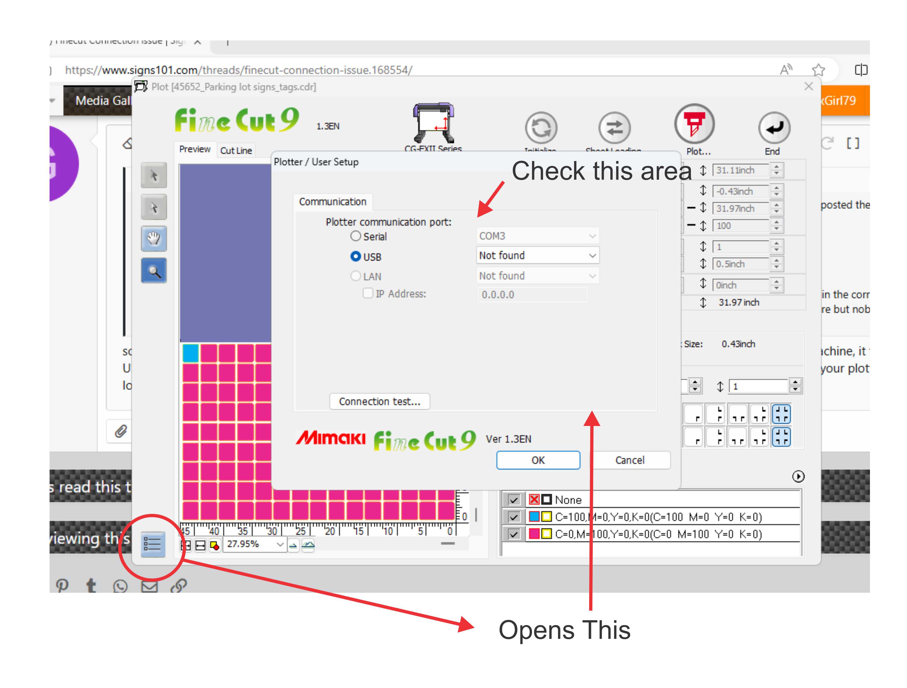

sometimes pulling out the cord and sticking it back in helps. :p seriously, my computer looses connection all the time with our machine, it turned out its the USB cord.. but its' SUPER long. Did you check the little box ( bottom left hand corner) when you try to cut something in Coreldraw ( we use X9), that opens your plotter / user set up? I'm looking at mine and right now it says that my USB is "not found"... but it was cutting 2 seconds ago. Sometimes I have to change it because it will revert to the other connection options.
