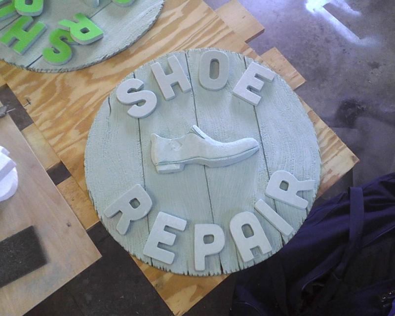

Just like everyone else here... I was very inspired by Charlie's (RogueRoller) work. Charlie's work is so good that it has even gotten my father so excited that he is up and moving around again. He was so fired up to get working on something, so we made an inexpensive hot wire table, and ordered a few tools.
This sign is for nothing other than the learning process. Still a work in progress... but this is where we're at. Letters and shoe are not attached yet. Going to call about some StyroSpray on tuesday so we can get this thing coated and painted.
Would you guys recommend mounting the letters and the shoe before coating, or coat seperately then mount?

searched around to see how others constructed theirs. Basically just a guitar string, mounted with an aluminum arm, some plywood, and a power supply. the only thing I had to purchase was the arm, everything else was already laying around the garage.

Great looking first foam! If the shoe fits...
I would seal them individually since you're mounting on wood & not foam.

that 'wood' is actually foam made to look like wood.... so i'll consider it a success! haha

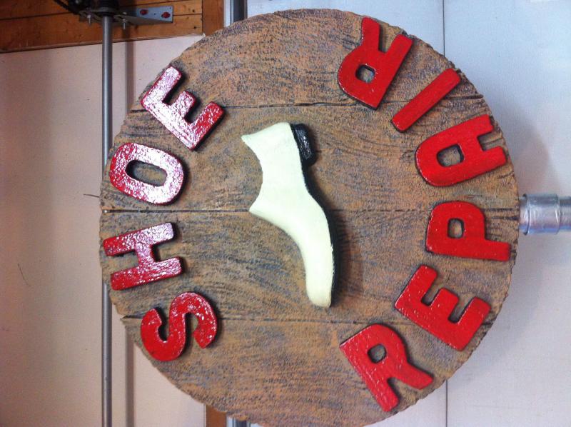

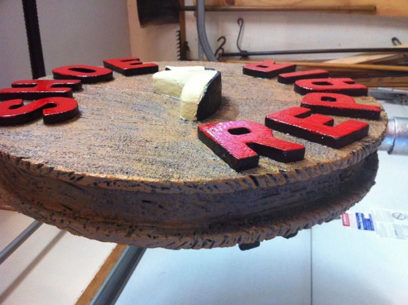

Well... here is is all painted and assembled. The letters still need to be touched up a bit.
I'm not completely happy with the texture of the coating. Used a poly foam coat from Demand Products. It's a brush application... I'm thinking the styro spray will give me a smoother finish.
EDIT: not sure why the upload rotated my pics, but oh well.
