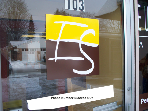

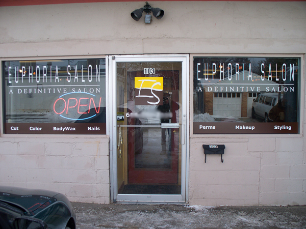

I've been in the window tint business for about 6 years now and have been moving into the vinyl business over the last year or so, mostly just cutting and selling decals, a few yard signs.... but have looking more into doing store fronts and vehicle lettering and just completed our first store front job.
I got a lead that a Salon was looking for some lettering on their windows and went down and took some pics of the salon then went back and photoshopped a design onto the pics, then mailed them the idea with a quote on price.
A week went by and we got a call from the salon saying they want us to come do their windows, but want a few small changes to the design. So I went to the salon with my laptop and made the changes to the design, got the papers signed off and went back to the shop and got to work cutting....
Anyway, I have absolutely no clue what the average price is for this type of thing. They didn't flinch once about the price I quoted them.... before I tell you how much I quoted them.... can I ask what you would have charged?
Here's the completed project... followed by the dimensions.
The large side windows are 62" wide x 43" high.
The door is 37" wide.
The White vinyl on the side windows is 57" wide.
The 3 color logo on the door is 16" square.
The job included all the vinyl you see on those windows.
There's also a phone number on there that I blocked out for these pictures.
I used Oracal 651.
What would you have charged?

$400, with a replacement guarantee. So, chances are we'll be replacing it.
klemgraphics
I can guarantee you will be replacing it, using cheap materials that will fail is not a good way to start off your reputation. The only thing 651 will touch here is coro or a racecar, never on anything permanent, especially outdoors.
Use good vinyl that will last but never give a replacement guarantee unless you want them calling you after someone peels part of it off, they will always say "it just fell off", yea right.:banghead:
Not trying to bust your chops just advise for the future.

Without knowing all the exact sizes i guestimated $400-$450 so looks like you did decent then. Not saying i know anything but going off the rough sizes it seems good. Thank you for not doing this for $200 though. Too many people do that type of thing.
I have done 651 on windows and have never had one problem. I guess it really depends on your area maybe but no complaints here. Hell when i first started 5.5 years ago i used 4 year vinyl cause i didn't know any better and i had a customer last fall stop by and her graphic on the back window looked mint condition.
iSign
$400 seems ok to me too... not great... but ok... as long as the drive was short... I'd be at $150 just for the door though... even a block away with supplied vector art... but then, once I'm there.. another $150 each to slap $20 worth of cut vinyl on glass? sure... why not... 3 years ago, maybe $550... but $400- $450 is very profitable even with 2 mil material (in my opinion)
