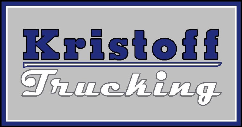

Attempt Number 1: Simple
I tried to keep this as simple as possible. Comments?

really nothing to critique, it's two words, two fonts, basically two fonts that never should be together.
put this one on the bottom of the pile and do another one. you'll have to step away from a design and try a totally different angle to really get something special. keep pumping out designs, one will start looking good, then tweak that.
just putting two words. with two different fonts isn't really effort.

Thanks for the input ddlarklak. You're probably completely right. I'm so new at this that I actually kind of like the font combination :doh:

I won't go into specifics, honesty there is a lot wrong and you need to learn basics before you understand the kind of critiques you'll likely receive. I think the best path for you, (if you really want to learn this craft and have patience for it) is to design say 10 different options. I'm talking totally different concepts (not just a color tweak here and there...colors, fonts, basic layout, composition, etc.) Then post what you think is your best 5. Or maybe 3?
Give it a shot, and we can get specific from there on why one works better than the others, etc.

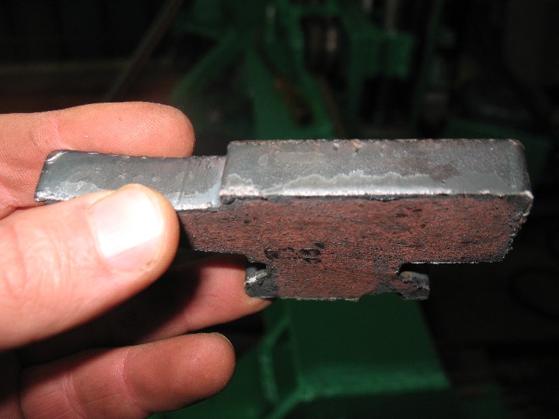

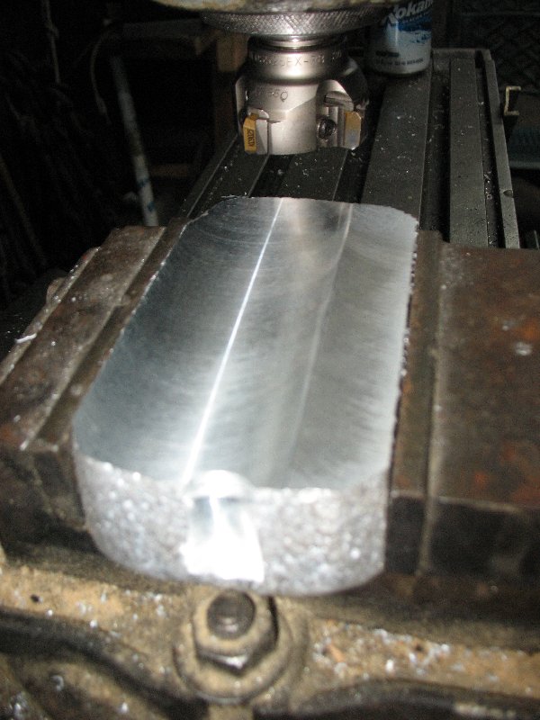

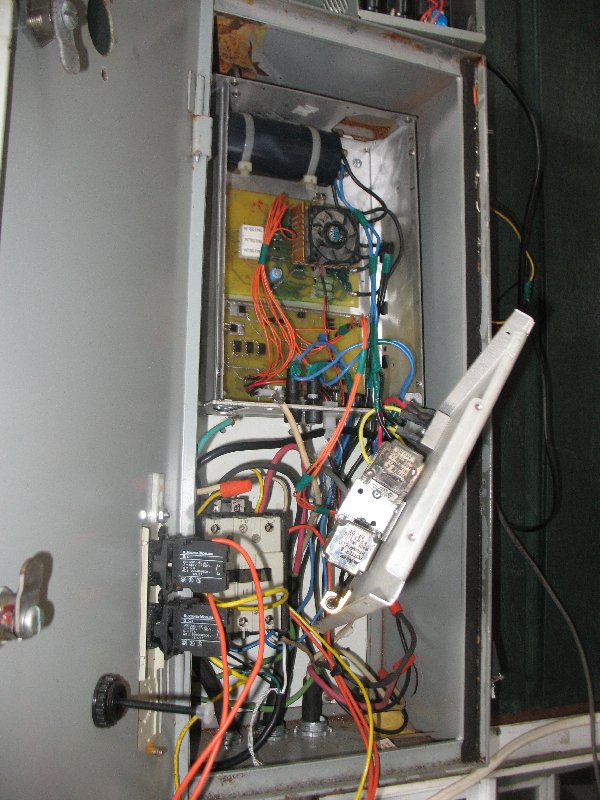

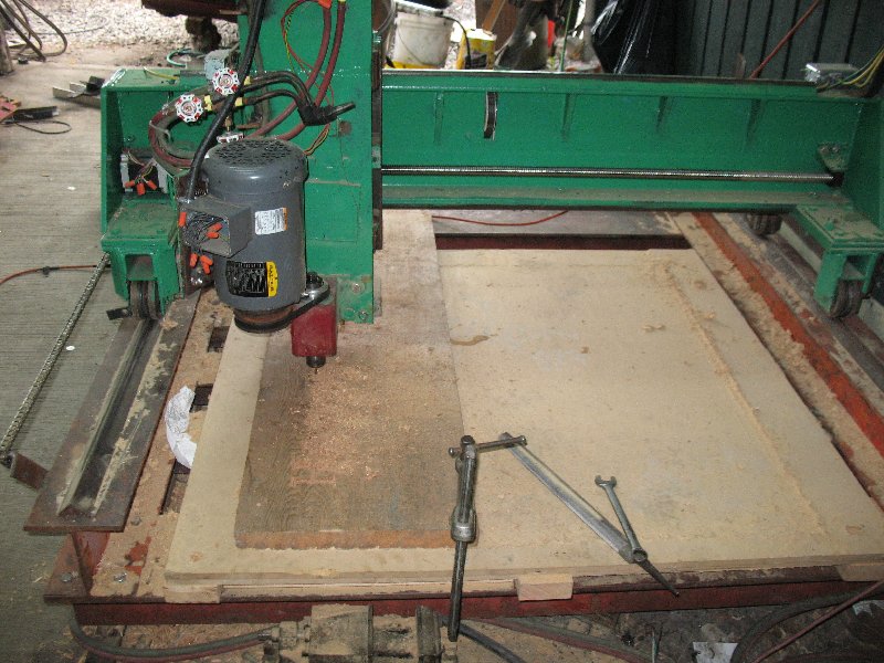

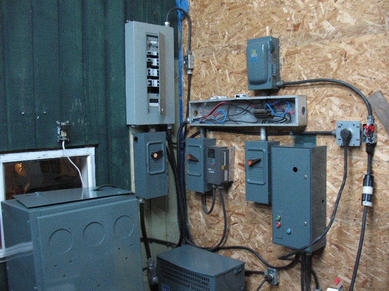

Some people asked about my CNC machine. A friend and I have built a 4' by 4' CNC wood router/plasma table over the course of a year. Most of the actual building only took a few weeks but waiting for parts to be shipped from ebay was the real killer. Building this machine was a huge learning experience and continues to challenge us today.
Throughout the build we often tried the do-it -yourself approach as it has been just a hobby. This approach resulted in us achieving among other things: basic aluminum casting, designed and successfully built/programmed a 3 phase 600V 20Amp Variable Frequency Drive http://www.youtube.com/watch?v=uDg_Az-_Qz0&feature=feedu_more and installed a stepup transformer and phase converter in my shop to get 480V 3 phase.
Now that 95% of the physical build is complete we have spent a considerable amount of time learning CAD/CAM software, reading books on proper GCODE techniques, and general tweaks to get the machine to be as user friendly and intuitive as possible. Our first table has some flaws however, mostly table size and maximum velocity during rapids (limited to 300 inches per minute). Plans are in the works for a second larger 10X5 CNC table.
Although the CNC machine functions quite well many mistakes were made. The learning experience was well worth any expense or investment of time. I'll attach a few photos taken from awhile back, quite a bit has changed now and the shop has been cleaned up.

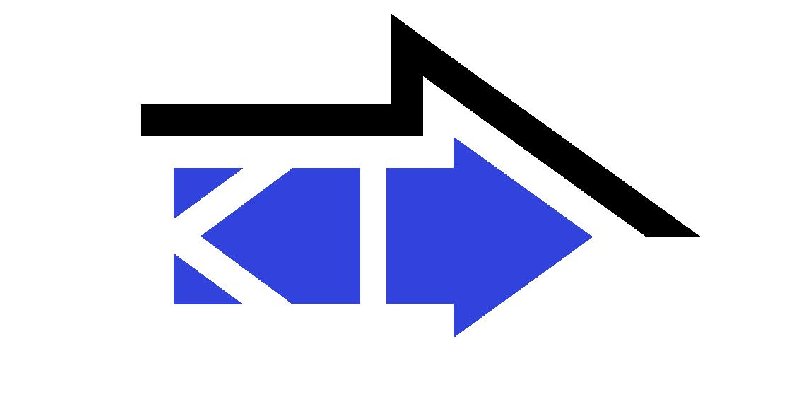

I came up with something I thought was interesting. It uses the standard street light colors (trucking related), and contains the company initials in...negative space?
Comments appreciated, thanks!

A few alterations. This whole concept might just be a bad one though, moving on to new ideas.
