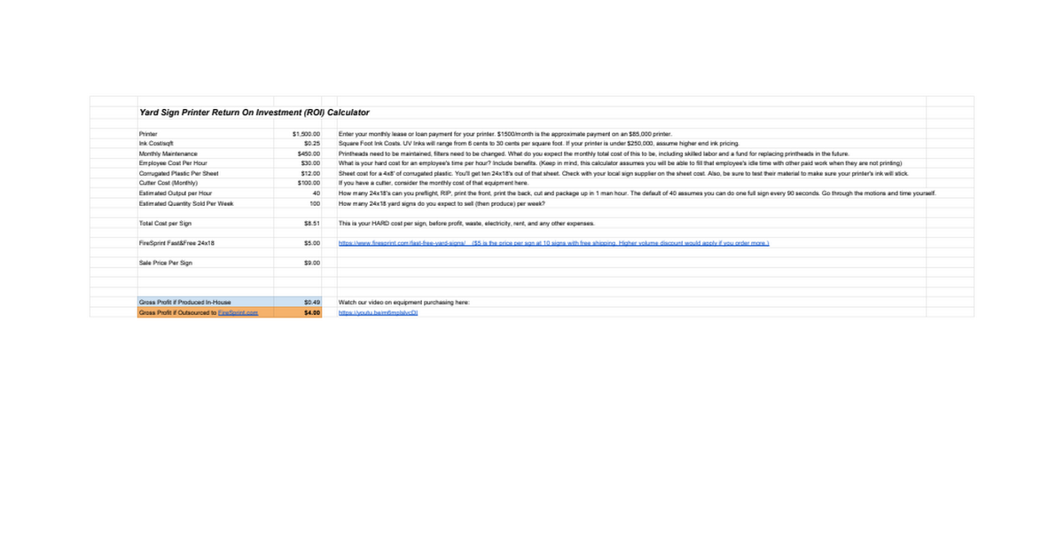

I made this spreadsheet for you to consider:
We also have a video on making large equipment purchases where we go into detail about something like this (Hint: We generally encourage people to buy their own equipment, but not to make yard signs specifically. There's good margin in larger and/or specialty signage and if you do a lot of this, a printer might be well worth the purchase)

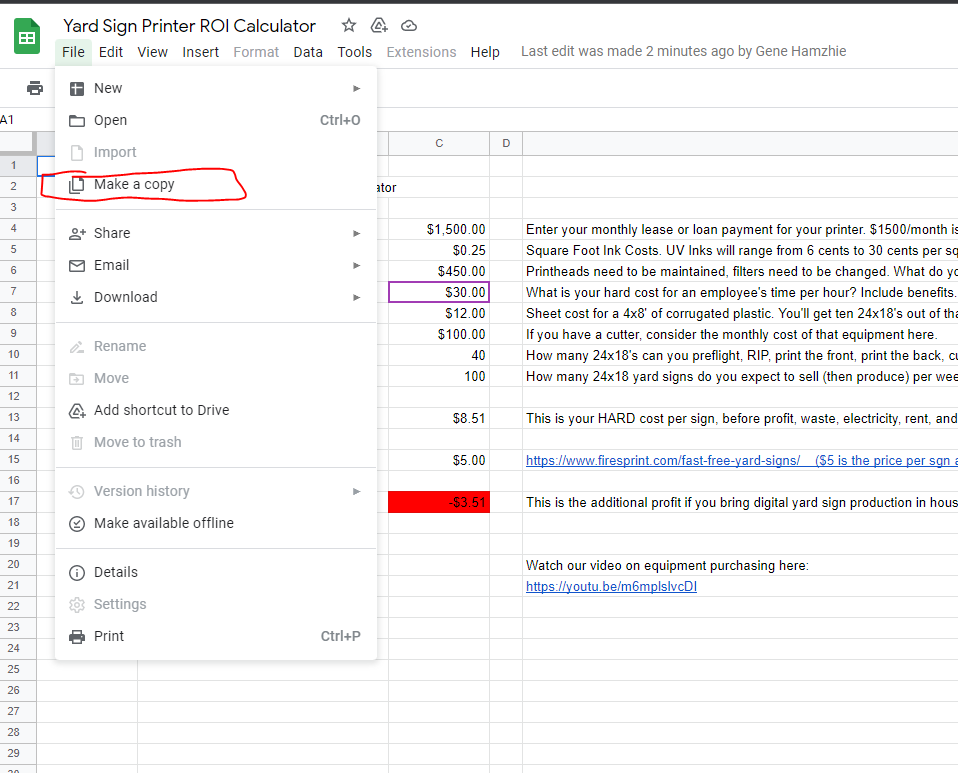

Also, to edit that spreadsheet as you see fit, you can make a copy to your own google account:
