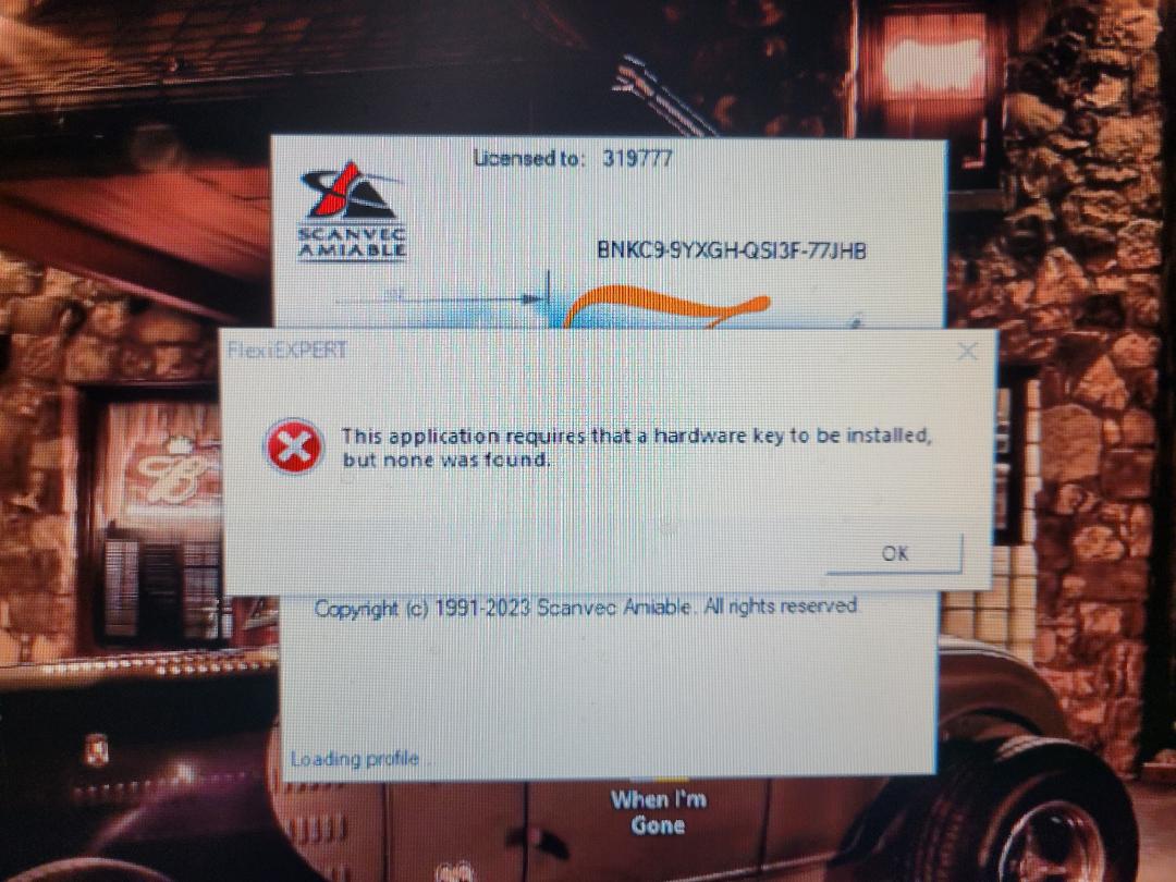

First thing I did was read the System Requirements on the Readme PDF on the disc and it said,
Windows 98 / ME /Windows NT4.0 / 2000 / XP...
I am running Windows 10 but figured I would give it a try...
I first inserted the key into the USB and then turned the PC on...
Then installed the program using the CD and it installed and seemed to go well...til the end....
That's when it informed me that the 16bit version is not compatible with my 64 bit system...however it seemed to install...
So I restated my PC......and yes, the light on the tip of the key stayed lit...
However when I tried to start the program it told me that it would not run without the key, which remained plugged in and lit...
Thank you for your help :) much appreciated:)

I tried the "compatibility mode" however win 10 was not listed...thanx :)
okeesignguy
Might just need to install newer drivers for the security dongle since the ones on the disc are probably not compatible with Windows 10. Also might need to run it in Compatibility mode which you can set in the program shortcut properties.
Tried that...it didn't work...thanx :)

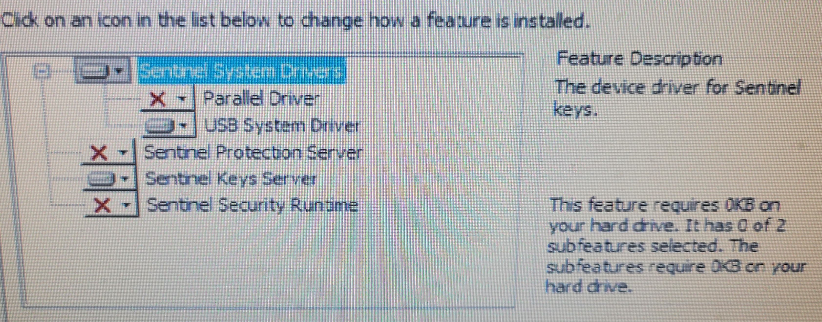

netsol
NEVER PLUG IN A USB DEVICE, BEFORE THE DRIVER IS INSTALLED
it will just become a composite device (nonfunctional)
NO IDEA if ver. 7xxx will run on windows 10
okeesignguy
I installed the driver...shut down...installed usb...restarted the pc...in that order...thanx!
