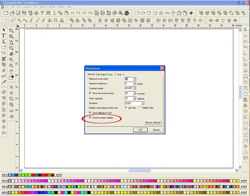

PMG
Try this in Edit /Preferences

hmmm actually looks like they changed that option in 8.5 because I dont see it under font options anymore. Also mine dont really look grainy either like I remember in 7.6
edited.... Ok thats where it is now in 8.5 where pmg is showing. It looks crisp on the screen with that screen smoothing checked!

Matthew Scher
Flexi 7 has an option to smooth text (edit>prefereces>tools>text), but in Flexi 8 and up we now have an option to smooth everything (edit>preferences>general)
On most systems there is no performance hit, but we did find a few cases where you can see a big slow down. The option defaults to on in Flexi 8, and the special cases that have caused a slow down have been fixed in 8.5.
