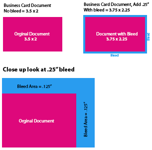

Im trying to export business card files to my guy that is printing them for me. Question is how do I save the file when expoting it? This is what they say I need to do.
Can anyone give me the steps on how to do this, my way isnt working with them.

For any original document size, add .25in to your document size. Please remember that bleed rules apply to all document sizes. Here is an example of a business card document with and without bleed.

Can't read what you attached, but just like gmr55 said, make your background bigger. That way there will not be a border and text is still within the card.

I set my design central box to those sizes. Now when i export it in a jpeg, do i
my artwork is 2 in by 3.5in, the file size says 2.125 by 3.625
i go to export, then jpeg, surpress options is clicked.
Would that work? by what i did?

No artwork would need to include your bleed. Select your artwork. Click export. Choose "selection only." Export as a PDF.
