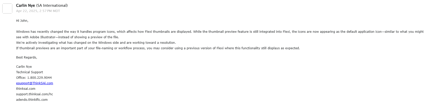

One of my issues was concerning the way thumbnails no longer show what's in the file, their response, go back to an older version... I can't because the older version doesn't support my printer!
