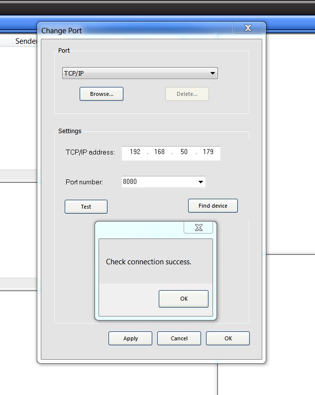

New issue just started. FlexiPrint version 12 w/ HP Latex 315. When I send a job, it processes through RIP and Output just like it normally does, but the printer never prints anything. I went through HP tech support and they could not find any problems. The printer is accessible through the IP address via chrome. Flexi polls the media width like normal and asks if I want to save the new size as default. When I called to talk to SAi, they basically told me to pound sand that they are no longer offering support unless you have the latest software with an active subscription.

Check the port settings. Flexi tends to default back to "FILE:" instead of the proper port which in your case will be TCP/IP. I've seen that happen a million times.
Solventinkjet
DIY Printer Fixing Guide
Well that rules that out. My next step would be trying to print from another computer. If that doesn't work, it would indicate a printer issue. If it does work it indicates a computer or other hardware issue.

Just figured it out. Apparently, Flexi only works with certain ports. Port 8080 was what was selected, but I kept seeing something about port 9100 and when I spoke with HP support, they said something about port 9100. Just randomly, I switched the port on the printer and RIP and sent a job and it's actually printing.
Thank you everyone for your help with this. Insane, that it is something that is so easily changed.
