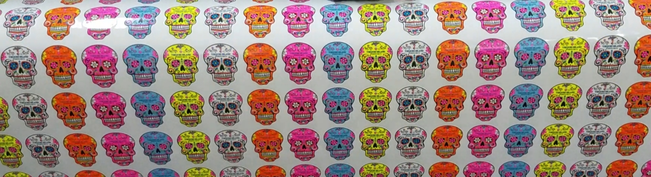

On our Seiko W-64, we have Neon Pink and Neon Yellow ink. To get the Neon Orange Color we overprint the two colors then we bump up the Vividness and Saturation if we want it darker.
The Neon colors don't last long for outdoor use even when laminated.

niiiiiice prints! if I were to be a client demanding my artwork printed as fluorescent colors...you would NOT disappoint! Printer ink sets just keep getting better & better!
