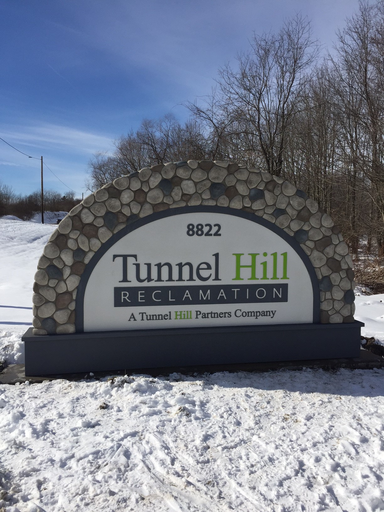

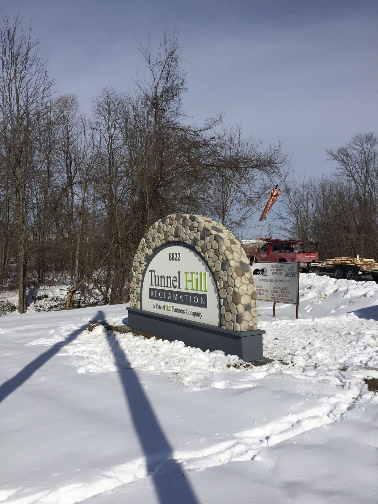

Installed this 9' H x 15' W custom foam sign this week. We designed the sign and had it manufactured by one of our vendors. Poured a pad with sonotube inserts a few weeks ago when the weather was a bit better. Installed with PVC sleeves inside to accept 3.5" steel tubing. The client was quite pleased with the final product.

how much was done by peachtree? nice looking sign.
They fabricated the sign from the drawings that I provided, in two sections - the gray base is a separate piece. They placed PVC sleeves inside the sign at the locations specified. We poured the pad with 12" sonotube inserts, we set the sign with 4 steel poles inside, and concrete in the 36" sonotubes. The poles extend up into the sign - two longer toward the middle, and two shorter poles closer to the ends.
