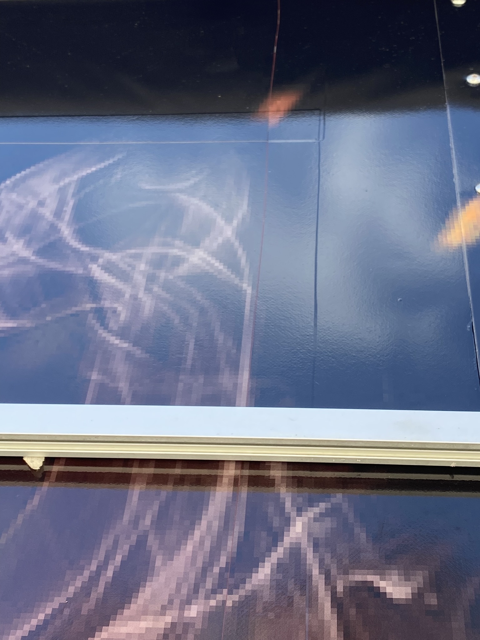

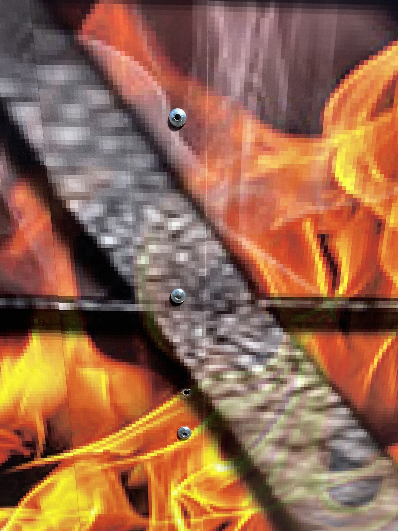

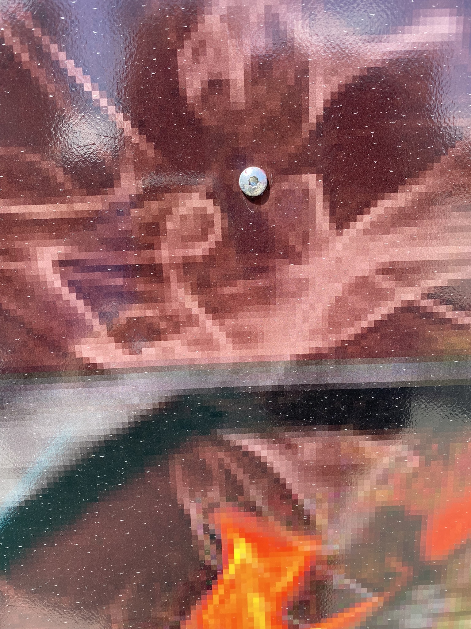

I have a new customer that has 5 food trailers she needs wrapped. She had a gal down the road do 3 of her other ones. 2 turned out great, one was very pixly and she requested the lady re-wrap them. She asked me what I thought about them. I said the two looked great and the other did seem a bit pixly but I was careful not to make much of it. Anyway, the gal offered her 1/2 the money back then agreed to re-wrap, then refused. Now this lady is suing her.
This is a food truck so they are viewed close up. I think the right thing to do would have been to stop printing and have the customer stop in at the shop to sign off on this before printing the entire thing since it's quite pixly. I'm wondering now if maybe she does not print in-house and that's why this step was missed. I calculated this to be about $900 in materials and if she ordered it from say Signs365 it would be much more than that.
At any rate, I think this lady is in the right and so far has been very nice to work with. I've done quite a bit of printing for her menu boards, etc. and she's been very happy with my quality.
I think this would be a nice gig to pick up. Do you think this lady is being too picky on the pixels? I think it's bad but food trucks is a new area for me.

considering viewing distance.... and the fact that people are standing right next to it - yah, it's pretty bad. You can get good quality images, and in the grand scheme of things, they really aren't that expensive.

My first thought was to wonder what is the resolution of the original files... Pixilation usually has more to do with the quality of the original files than the print settings. I would agree that the wrap in the pictures is poor resolution - but is that because a small file was stretched?
You can use one of the AI photo software brands to improve, somewhat, pixilated files, but don't expect the miracles they advertise. One of my favorites is Let's Enhance:
I would strongly suggest some samples at full size before printing and rewrapping

I don’t think she’s being too picky. That is really bad for a vehicle wrap. I personally would not even start printing that. I usually look at the file full scale before sending to RIP and if pixelated, I send the customer screenshots to show the pixels and to confirm they are aware it will print as such.

I don't think the lady is being picky. I've done my fair share of food/coffee trucks. That's real poor quality. I think you can handle this. I do the same as you. If I get a low res file from the customer, I tell them. I'll print out a piece and have them sign off or offer to recreate the art for a fee. I get everything in writing.
Precision
We try and educate our clients on the difference in quality between vector and raster based files. At first hint that the client wants pictures on their wrap, we have a rather lengthy conversation about picture size and minimum resolution before we even consider designing.
For someone to print the whole food truck and not stop after seeing the quality in the first 3 feet of printing, says a lot about that guy.

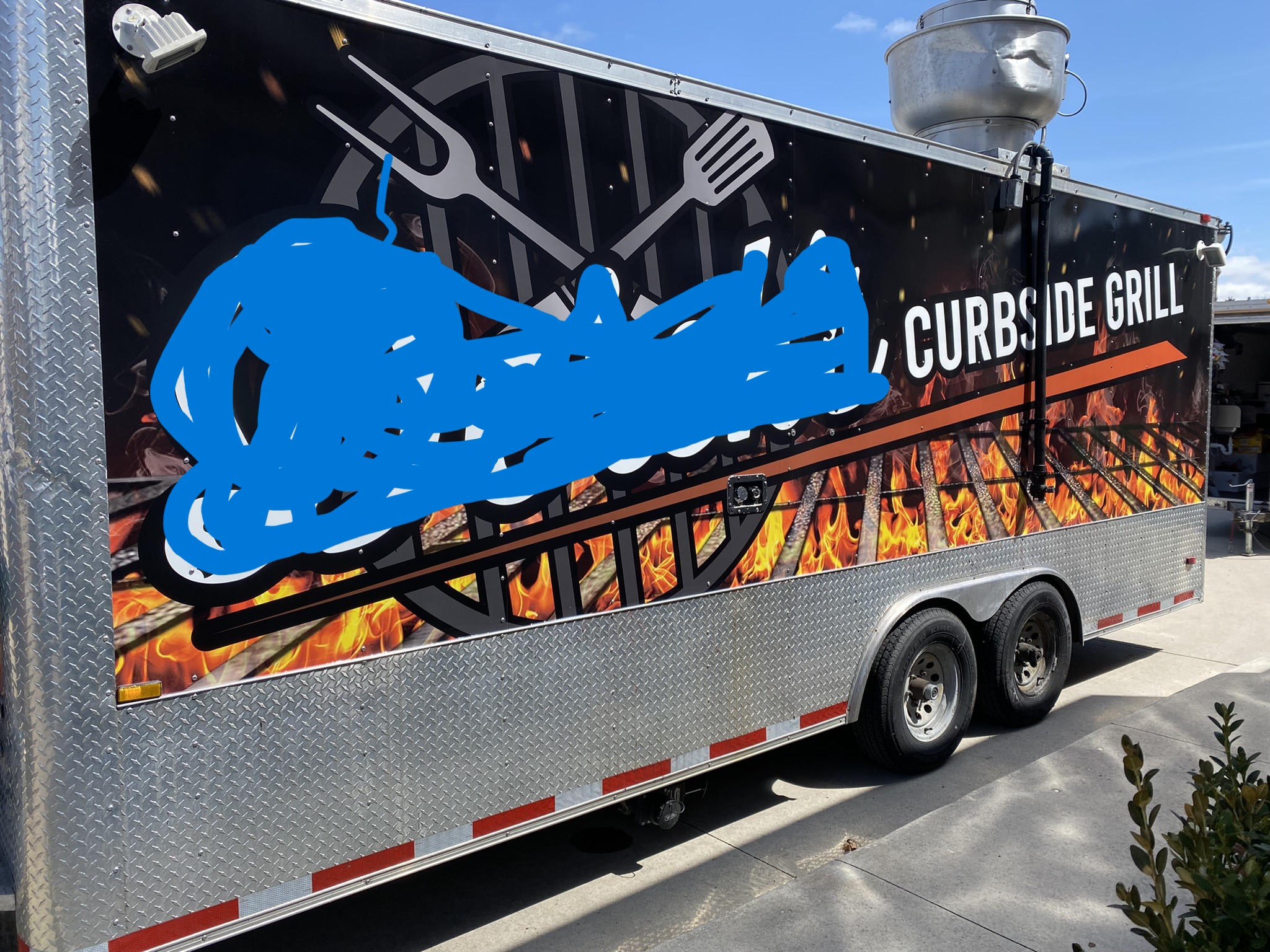

Yes - all from the same trailer. I attached a further back photo of the back side.
The wrap girl, who is a graphic artist, supplied the art. The flames are from Shutterstock or Istock, can't remember which. When she discussed this, the wrap girl stated the flames looked good until she added the grill overlay, that's when they became pixelated. So - the issue did not seem to be with the flame artwork. Out of curiosity, I should look for the flames.
The wrap job itself looked good. All her other trailers look good also.
I would assume there was some kind of proof...probably similar to the photo I attached.
She paid around $5,000 for the art and the wrap.
