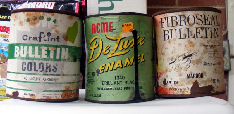

i guess iam one of the few........that still has NOS LEADED 1 shot. an old sign guy here passed on and i was lucky enough to go in and buy all his NOS 1 shot, chromatic and even some old CRAFTtint & FIBEROSEAL.
and some really old ACME!!!!
