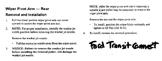

Anyone know how to remove the rear wipers on these things? We've got a client who bought 2 out of their 4 Transits with rear windows and wipers (whatever was on the lot), but wants the wipers gone. We've got the nut off, but the wiper arm doesn't come off easily and we don't want to damage it. We can't tell if it's threaded or if you just pull.
The most info I can find online is "Remove the wiper from the wiper post."
Jesse_gvi
We finally got a dealership to fax us the info. It does just come straight off, but you need to use a 2-jaw puller, or what we call "2 pliers and a scrap of plex."

Hammer the end of the screw part while pulling...
