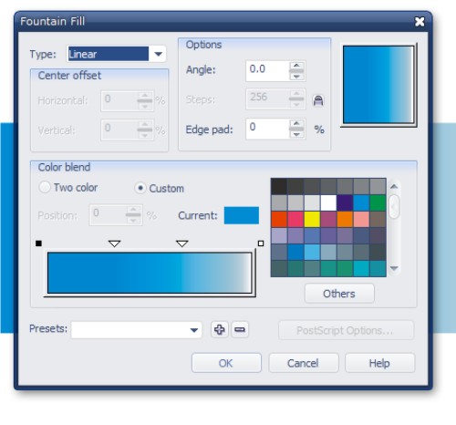

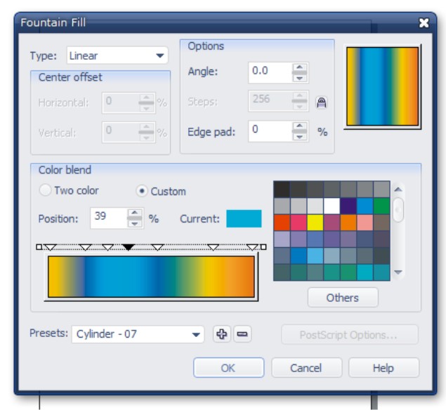

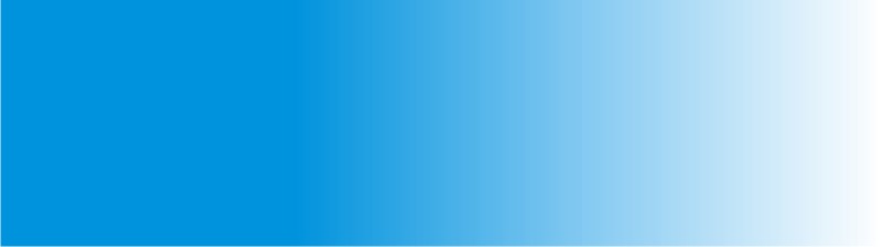

go through the presets and select a fill that has multiple color points
and edit to the colors that you need.
