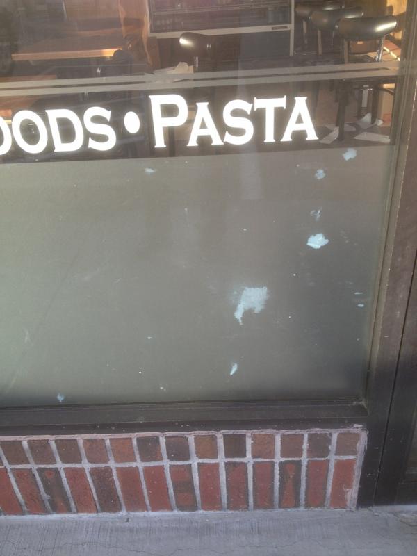

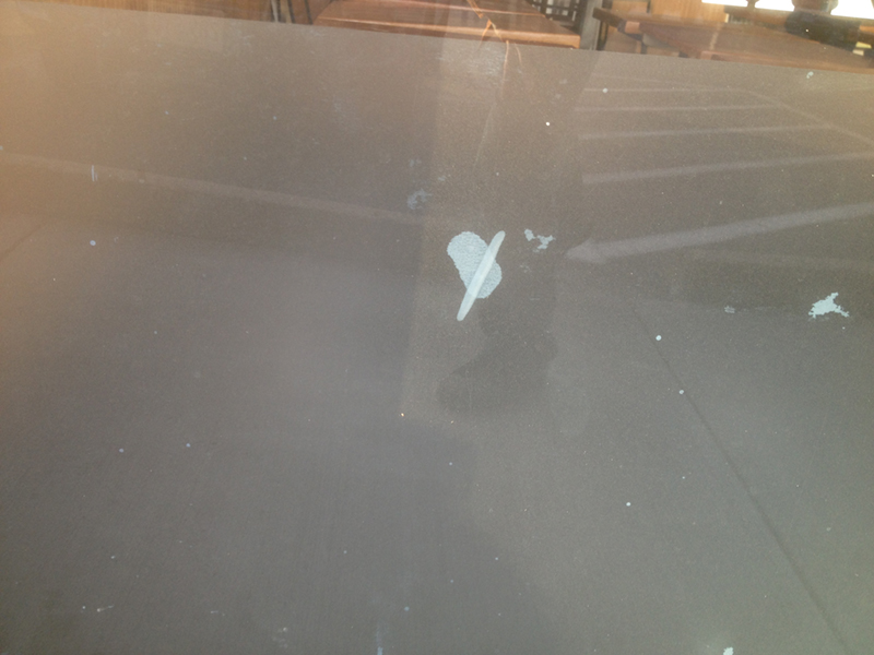

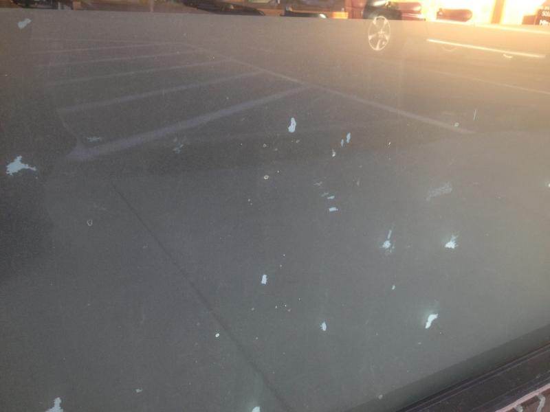

So, i go to apply two windows 24"x80". i use rapid tack on the second one and water on the first. no transfer tape and cleaned the windows with ammonia free glass cleaner from that company in florida. it works really good out out vehicle and store front windows.
after applying everything wet, strong arming with a golden squeegee, everything looked awesome when i left the jobsite.
i had to return the next day to finish up and to my horror:
white spooge marks everywhere underneath the frosted.

frozen/crystallized moisture beneath the vinyl?
if so, nothing a few pokes (blade) and a blow (heat gun) can't cure :)

I never saw anything like that, it looks like whatever you used froze.

Man I have just seen the pictures you posted.I have never seen anything like that.It looks like paint.
Just apply like I said and make sure the surface is real clean and you will be Golden.

I've never used rapidtac II before. Only problems I've ever had was if I center hinged long pieces and had paper bits show up later. They are see through when wet. But this seems strange like some form of reaction of some sort. See if you can work it out some way with a little heat.
