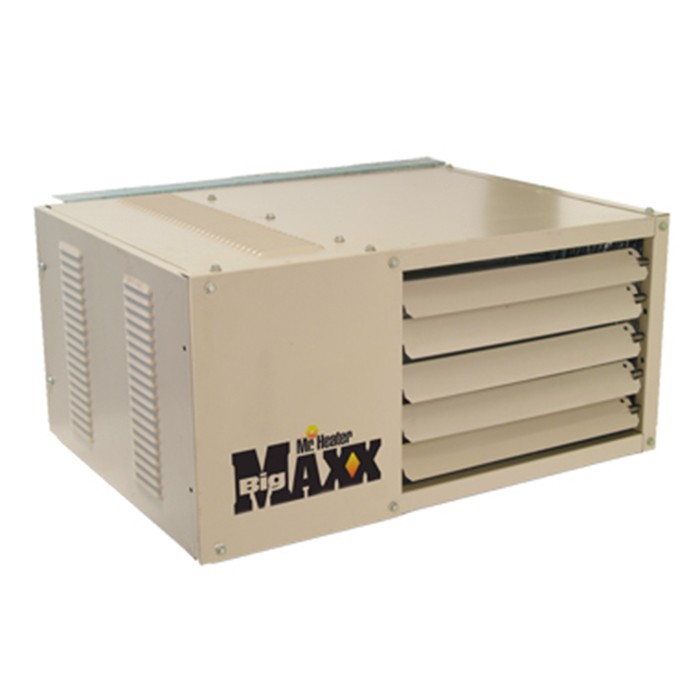

I have been looking at the 80,000 BTU of the Big Maxx
http://www.mrheater.com/big-maxx-natural-gas-unit-heater.html
Pretty cheap, but the vent kit for going through the wall is 4X the price as venting through the roof.

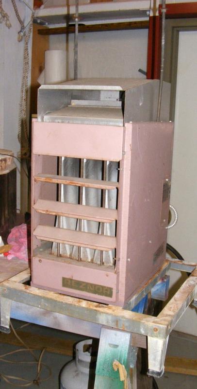

i got a REZNOR 30,000 BTU........got it used for under $100 will take my 24' X 30' x 16' tall shop from 40's to 70......in less then an hour.
They go on sale at TSC Store here in Canada once in a while.
We just put one of these in our tool room that tends to be colder than the rest of the shop during winter. Don't know how well it works because this is the first week its actually going to be cold again at night so I should have some input back from our employees in a few days. I think we went with the 40K BTU Unit.

We had the local furnace place come in and they refuse to install the Maxx heaters, and would charge $5,000 for a furnace and install to heat a 24' x 24' garage attached to the house.
I found the Maxx on sale at $650 and another installer ballpark it at $1,000 for the install and hookup.

as for the reznor i have its a 30k. and for my shop with insulation and being in northern florida........it does a great job. to try and heat all the space you have will take closer to 3 OF THE ONE I HAVE!!!!!! 90-120k btu.

The 80,000 BTU Maxx heater is actually 64,000 BTU because it is not 100 efficient.
TonyC what would you think would heat an insulated 24' x 24' x 15' ceiling attached house garage in Ontario Canada where we get some pretty cold weather? Can you take a stab at it? I was told to get the 80,000 Maxx because the 40,000 BTU unit would have trouble bringing the space back up to temperature if the door is opened in the winter.

I used the S.W.A.G. (scientific wild @$$ guess) method. Guessing you have a -10F mean low temp and want a 70F inside temp, I would guess you will need 80,000 BTU based on average construction and a garage door.
All gas heater I have worked with were rated at input BTU. The output is calculated using the efficiency rating. The specs I found on the Big MAXX heater shows the BTU rating IS the output. You may want to verify that information.
player
Thank you TonyC. I am not sure of the R value but the garage is well insulated and has an insulated door with no windows in the door. The floor is concrete. One wall is the house.
I read somewhere that the Maxx 80,000 = 64,000 from Maxx I think...
But I think the 80,000 BTU unit will be the one. The other thing I have heard is they can be noisy.
