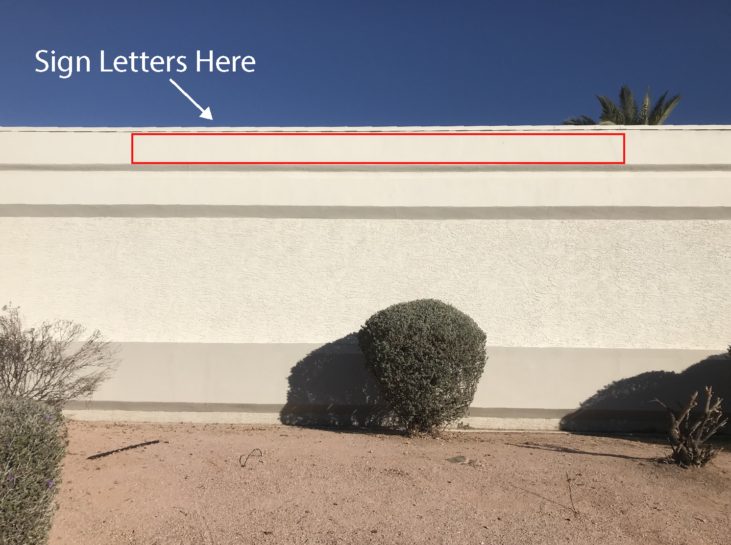

Hello, Thanks in advance for any suggestions you may have. This will be my first time installing molded plastic lettering on an office building. i have a few questions. 1). The building exterior surface is covered with stucco but I am unsure of what the core is made from and therefore not sure what the best options are for attachment. Should I use stud? pad? combo?.( I have attached photo of building if that helps). 2) Is molded plastic a good choice of material for these sign letters? And finally, I was going to use Gemini for these letters but I dont know if there is a better option or if anyone has any suggestions for other vendors that offer these letters. Thanks

Industry standard calls for a concealed stud mount. Adhesive alone will result in a substandard install that may fail.
Ask Gemini for a drilling template. Make sure the letters line up with the template I have received templates before that had mistakes, though it's rare.
Tape the pattern to the wall and drill holes. If the surface is EFS (like Dryvit) on foam, drilling will be easy. You can even start each hole with an awl. EFS is also applied to cinderblock, plywood, or other substrates.
If the surface is stucco over masonry you will need masonry bits and a hammer drill. Usually 3/16-inch diameter. Take a 1/4-inch bit with you, also. If any of the studs cause a letter to be in a serious bind, you can drill that hole larger.
Dry fit first to make sure the letter fits and will stay in place, and studs will not try to come back out. Then apply clear silicone to the studs by inserting each stud into the nozzle of your silicone tube and pulling it out. You can control the amount of silicone left on each stud by trigger pressure as you pull it out. Don't try to squirt silicone into the holes. This is ineffective and wastes adhesive. Just coat the studs and insert.
If a stud is too loose and tries to come back out when you dry fit, wrap a little tape around just that stud before you silicone it. Or, sometimes you can tape the letter to the wall till the adhesive sets up. Pull the tape off before you leave.
Brad in Kansas City

Thanks Brad. That answered alot for me. Would you recommend the pad in adittion to the stud or are those only used in the case of offsetting the letters from the wall?

Lol, You got me there. So the letters are molded plastic. 12" high caps and 9" lower case. 24 letters total. 19' total width and stud mounted. A tall ladder should be sufficient to complete work.

I have used pads a handful of times in 45 years. The additional adhesive area is generally unnecessary. And on smaller letters, they are unsightly, in my opinion. If you are worried about standing off the letters on the same plane with each other, you can use sleeves for spacers. Gemini may sell them. But they don't guarantee the letters will be even with each other. You still may need to tweak.
When I want an offset, I just eyeball it. To check how they look, get at one end of the installed line of letters and sight along their fronts. It is usually obvious if one is too far out compared to the others.

Are you actually using formed letters or are you using cut acrylic letters?
If you're using formed letters (hollow backs), you'll need to stud-mount. Brad covered the install method pretty well.
If you're using cut acrylic (looks nicer, in my opinion), you could tape-mount along with Lexel and you would be fine.
If the picture you posted is where the letters are going, that's pretty low to the ground and a pretty straightforward install. figure a few hours and charge what you need accordingly.
