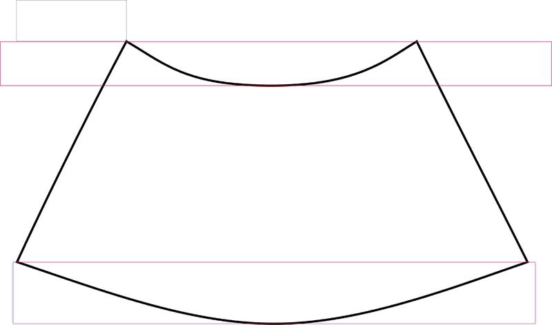

I haven't cut it out yet, but this is what I have so far. I took Gino's advice to determine some of the dimensions then using some node editing created this layout in Coreldraw. I think it still needs some tweaking.
Thanks Gino.
Thanks Gino.
I actually had a bunch of different sized tapered buckets that I had to make labels that wrapped around and overlapped. Took a bit of trig and lots of google searching but I came up with an excel spreadsheet that I was able to put in the diameter at the top of the bucket, the diameter at the bottom of the bucket and the height of the label and it gave me dimensions to plug into an illustrator template that I came up with that allowed me to warp the artwork to. I used static cling to test my cuts to make it easier to apply and remove, and got amazing results. If you need me to dig those out, I can do that... but if Gino's technique works for a one-off, Go for it. It would take some time to walk you through the process using my way.
