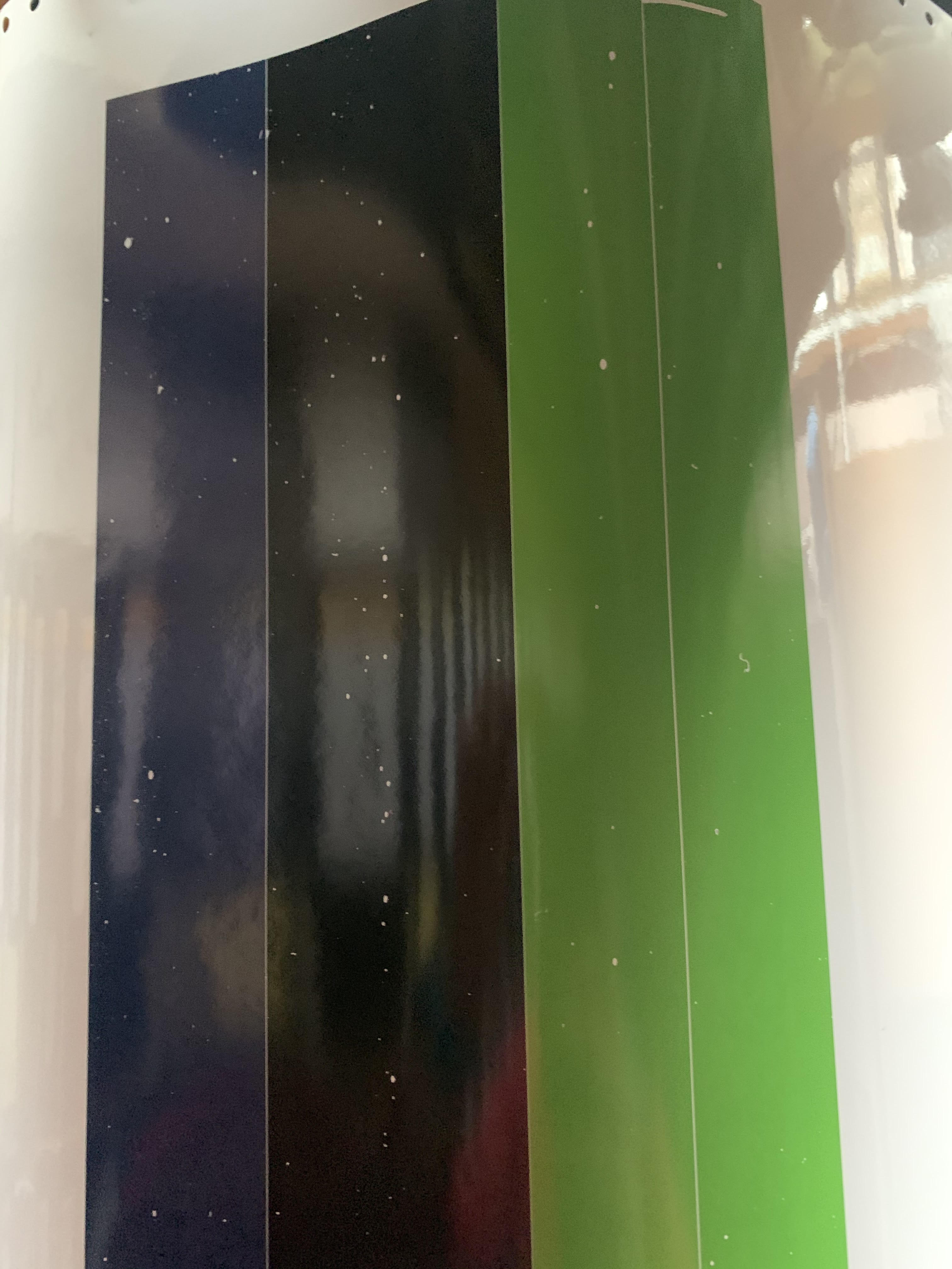

What about the white spots in the attached picture? just dust? or should I be worried about something else?

The white spots are what is called pinholes. They are generally the fault of dirty or old vinyl or foil as well as some third party aftermarket brands. They can also be seen frequently in the first print run of the day for the first few inches of printing. This is caused by uneven heating of the printhead and is corrected by running a short waste print.
You should also insure that your Edge printhead is cleaned regularly with a wipe saturated with at least 90% isopropyl alcohol. Less than 90% can lead to problems with printhead corrosion. Most sign supply distributors that sell foils will also have ready to use wipes that are either for sale or included free with foils.

Excellent Fred, thanks for that answer. I realised that after some more tests, white spots were dimishing...still there though. But printed colors are really awesome.
