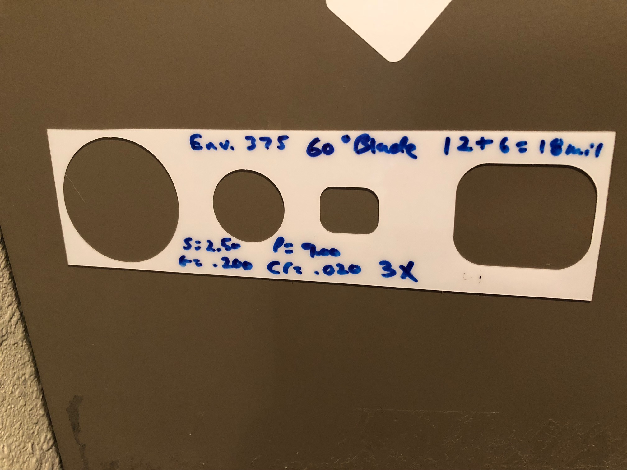

Jburns
here are my settings for heavy lam and convex three passes what fred said also

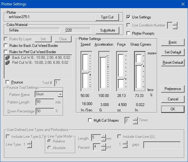

Fred Weiss
Merchant Member
Those are his advanced plotter settings. In GSPPLot enter F7 and then click the Settings Button for your plotter. S = Speed, G = Acceleration, P = Pressure or Force, and CR = Sharp Corners.

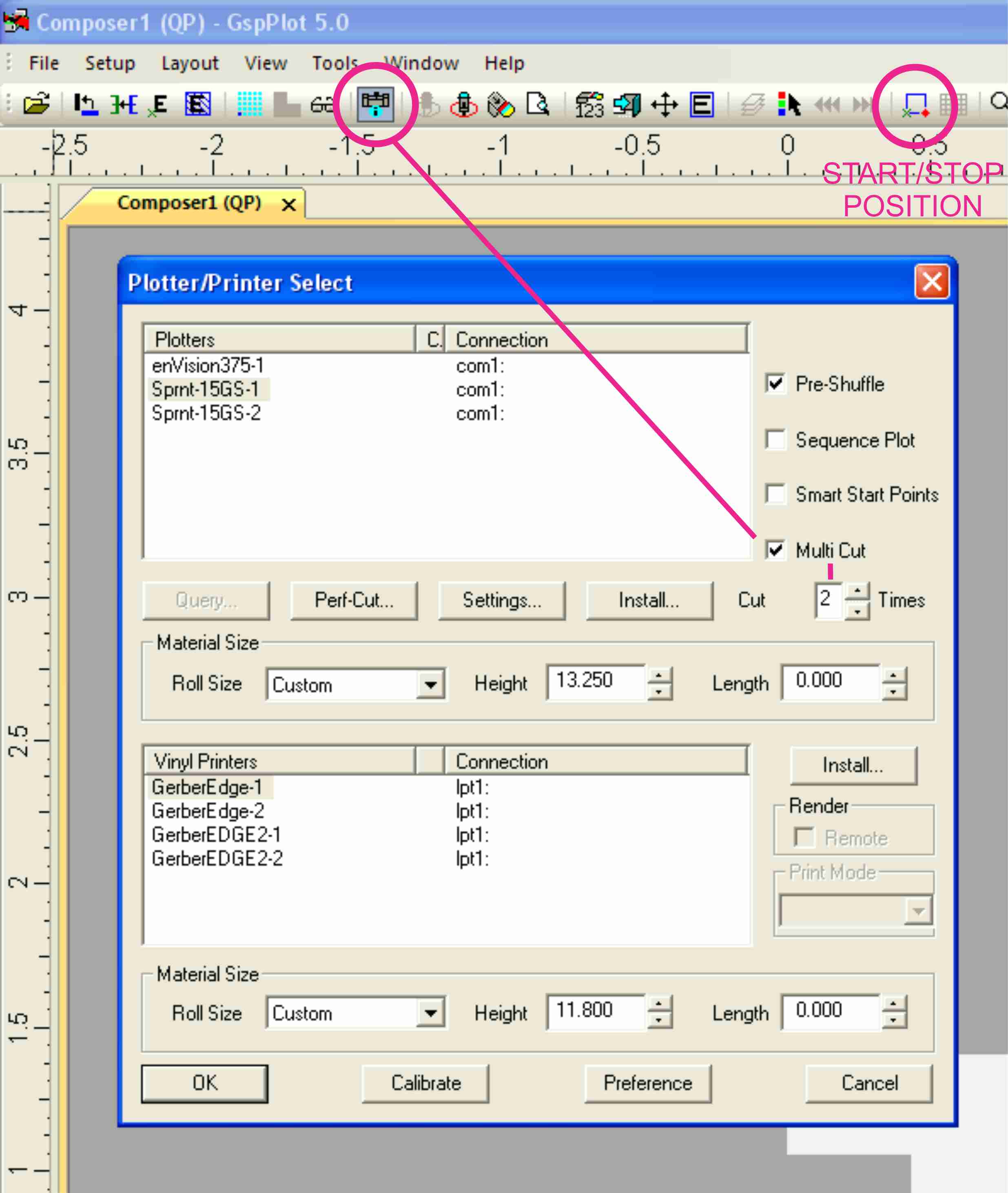

Billct2
and you can set the plotter to go back to the start position after cutting in case it needs another pass.
Billct2
here are the tools in 5.0, I think they were the same in 2.6
