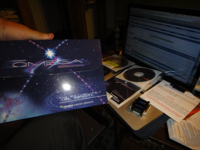

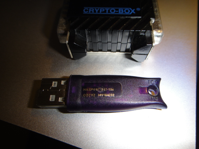

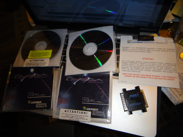

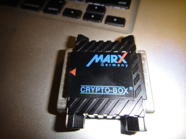

I have a used copy of omega 1.56 that I bought with a gerber edge. All the serial numbers are valid, I have the USB key. I also have a parallel port key, that the previous owner told me I needed to use, my local gerber distributor told me I do not need it, just the gerber USB key. I can't get the software working. Can anyone tell me what this key would be for and why I would need it? I am trying to upgrade to 5.0 but I need to get the installation numbers from the software. I am trying to avoid making a computer that has parallel ports and runs windows xp for no reason. I can't find anyone that has the correct computer setup, none have parallel ports and all have been non expansion type motherboards. I run all macs, so that is no help either. I was hoping to just invest in a new windows 7 computer and use omega 5.0 on that. Here are the photos of my keys and discs. The parallel port key has a five digit serial number, the USB key is absolutely gerber and is correct, the software serial number is also valid and has not been updated.

I checked with gerber and they said no problem on transferring and upgrading. I even asked if it was OK to upgrade even after it had been upgraded from graphics advantage. The parallel port key appears to be non gerber, the serial number does not have six digits. The USB dongle is gerber and has a good serial number confirmed by gerber. As for the installation, I start with nothing plugged in, then install rainbow sentinel, after a reboot I plug in the USB dongle and parallel port key. Windows XP will not recognize any driver for the USB key on the computer that has the parallel port. I have pointed it to the drivers, which appear to be windows 98 drivers. These drivers worked fine on one of the computers that had no parallel ports! So when I try and install the actual omega 1.56, it says it can't find the security key. When I purchased this software, with a used edge, the sign shop that I bought it from had to pull out one of his old computers and it took him a bunch of tries to get it to work, but it did install and did work. The thing that sucks is that string of numbers was available then, I just did not know that I needed it for the upgrade. The local distributor says that newer version of the software don't even need to be installed to get to this number, they told me the installation menu has an option for looking it up, but I can't find anything like that. As for password and serial numbers, I have them all and gerber confirmed they are valid for use and update. I am going to try and find the sign guys info, I am a hobbyist, so I have not been as diligent about chasing things down as I should have been. I bought the package months ago and as always life got in the way of progress. Has anyone ever seen a parallel key like that? I just hope I didn't buy a steaming pile.

Now that I look at the pics those are NOT Gerber devices ( USB key or the Parallel key)
Our security has always been with Rainbow which is now SafeNet,
On the CD's can you find any small sticker with a 7 or 9 digit number or something that says password because you claim a 1.56 but you show a GA 4/6 upgrade.
