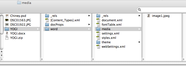

A client just now email me a dog photo place in a Word doc and i immediately thought of Rooster's post. I gotta admit, i didn't see the advantage of changing the extension to Zip, other than not having to use Word (which is a pretty good reason alone).
Change the extension, open this Zip and my first thought was "what's the deal with all these files, where's the photo?"
I find the JPG photo a bit burried... okay cool.

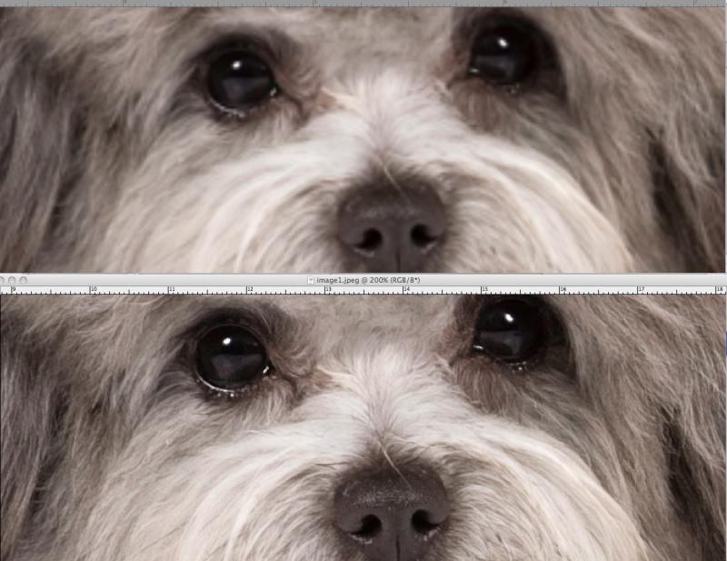

I'm curious to know if there any difference in the image quality in the JPG vs copying the image from Word and pasting it into Photoshop.
This side by side comparison in Photoshop, with no adjustments to the file.
the top image is from the .docx
the bottom image is the JPG
Get a load of this.... there's a tremendous difference in the image quality!!!!! Zippity Do Da Day!!!!

I missed the folder in there called "media". All the jpeg components of the doc file are contained in there. My sample docx was full of cruddy art so nowhere as good as gg's

Yes, there is a big difference as Gyspy Graphics noted, I'm pretty sure all programs in the Office suite output at 72 dpi by default

what I've noticed about MS Office, is that it upsamples bitmap images when displaying them (and often, they'll end up looking smoother and maybe slightly blurier), but if you cut and paste the image, you'll get the original un-upsampled image that is stored in the file.
