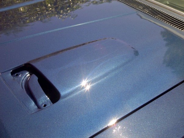

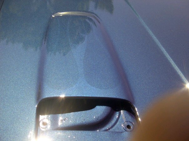

If you are just doing ghost flames, I would have them painted. Acutally just painted some ontop of my father in laws GTO this weekend. Dont think you can get the same look as painting them.
