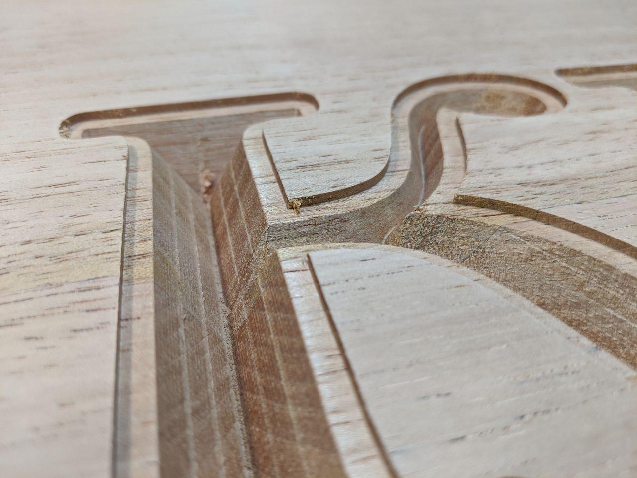

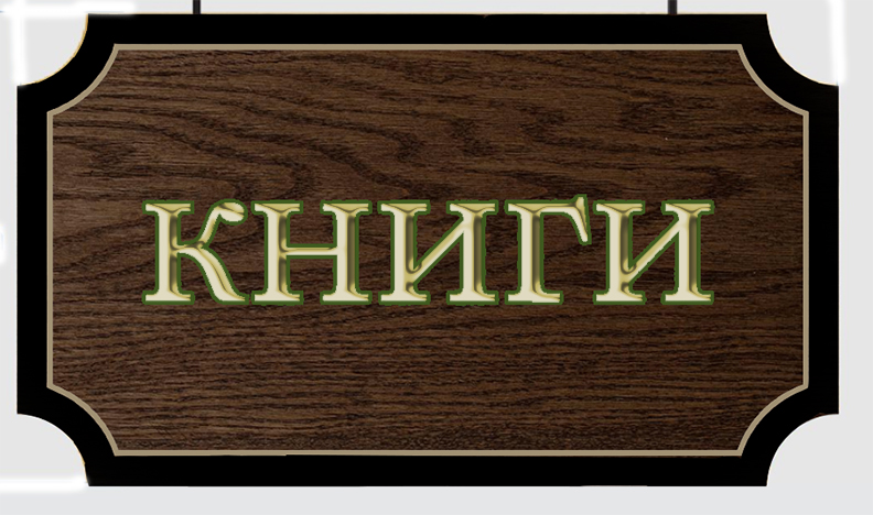

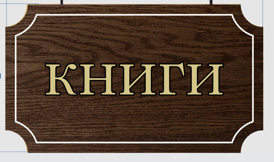

Hello forum.

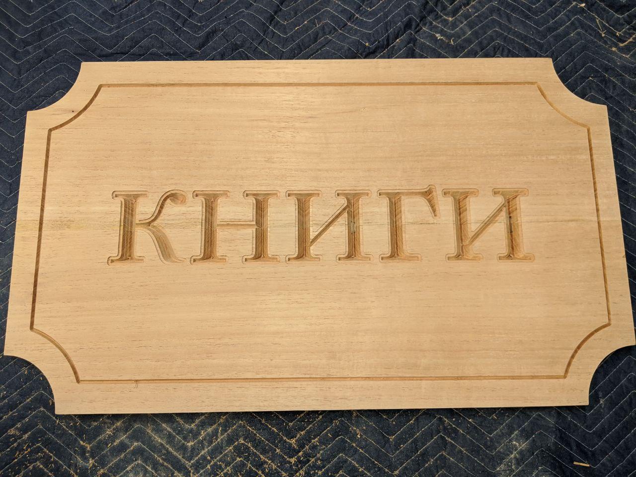

We are making an outdoor sign for our friend's bookstore.
Is applying golden leaf over an oil based polyurethane is correct?
The temperature there is between -20F and 80F.
It's spanish cedar, the wood will be stained with oil based stain.
Thank you.

I'd look into clear marine epoxy resin for the clear/sealer coat. Then let it cure all the way. Then you can scuff the V-carved sections, apply your size, then gold leaf.

I agree. If it's going to have to have a natural wood stain finish I would clear the whole thing with a 2 part marine clear. Only thing I have used that holds up. Is the outline getting painted? (and don't clear over the finished sign, the only time gold leaf should be cleared is on a vehicle, or glass)

Yes, the outline will be painted black with one shot.
Is there a brand of epoxy clear you can recommend?

Accordimg to your picture, you're gonna stain the wood a darker color. Do that first, than clear it, but don't use a sealer. Your stain will act as a kinda sealer. As for the clear, I like oil-based urathanes. Probably 3, mabye 4 coats...... and don't use a high gloss, try a satin of some degree.

He's right. You only clear it on fire engines and things which will take a lotta abuse. You can clear the board itself, before you gild it. Guess I took that for granted.

You should go with AWlgrip, Polyester Urethane, will not yellow outdoors, two part mix and get some brush additive thinner. Years ago I use to do mahogany sideboards for a boat yard. They would give me the board with about 3 coats of varnish on them sanded glass smooth. I would gold leaf them, before computers, outline the gold leaf and give them back to the yard, they would put about 2 or 3 more coats of varnish on them. They would last for years until boat got sold and renamed. Mahogany transoms would be accomplished the same way. Now most boat yards us Awlgrip clear instead of varnish. Holds up better.

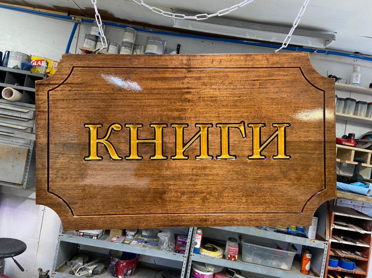

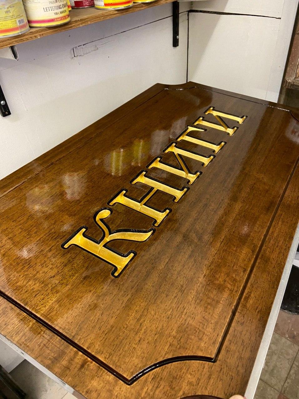

Hey all - we just finished up this sign today.
Pictures here - thank you for all the help on this project!
