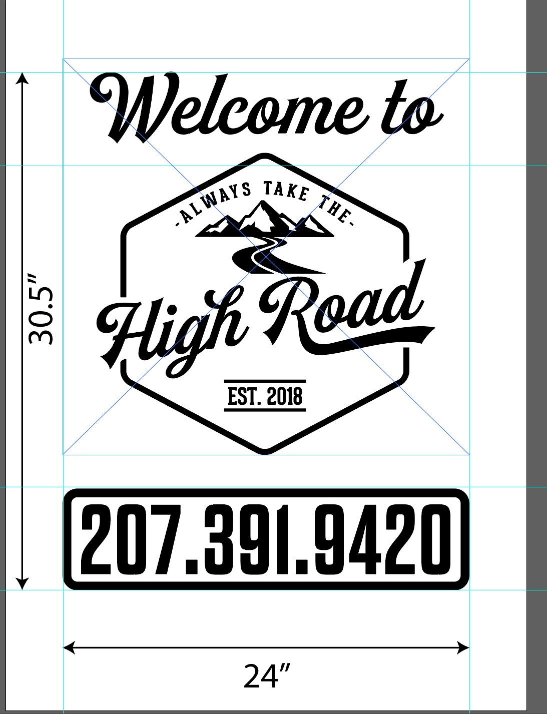

Still working on the design and details of this thing but I want to do it as correctly as possible the first time around.
Would it be wise to break these up into multiple pieces for ease of applying to the window? I was going to do the top text and logo together and then the bottom piece as a second transfer.
I'm just so paranoid of screwing things like this up. My customers are always in a hurry for stuff but I don't want rush through something new to me just to get it done.

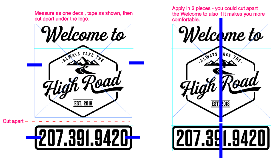

Cut the entire graphic as one. When you go to apply, you can tape 2-3 sections then cut apart and apply each section separately if you are more comfortable. I would tape/measure it all as one so you only have to measure once! If the entire process scares you, cut two graphics out and bring them both along in case you make an error, then you have a back-up. I recommend dry applying unless you are using Rapid Tac. If you are using Rapid Tec then I would just apply the entire decal as one, maybe horizontal hinge, do the bottom first, then the top. If you do the top first, the Rapid Tac will drip down and the paper backing will get wet and won't come off the vinyl. Then if that happens, you have to wet it and scrape it off - a real PITA LOL
Looking at some of the finer details, I'd use a decent cast. When vinyl has very little area to stick, it's always better to use cast, so those fine lines and dashes don't lift.
Also, what stacey said, but I'd go a step further and cut the welcome part off, too. Worry about getting the main part on and centered, then get the last two lines.

Cast, of course. Don't skimp on pennies and do it properly. Also, cut the vinyl in one large piece and put it on the window with a center hinge. Hint, always use 2" 3M masking tape. Don't skimp here either. In the case of this piece, use two pieces overlapping side by side for your center hinge. Then with a good pair of scissors, cut under the 'welcome' from the right edge to the hinge, try not to cut into the hinge but the world won't end if you do. Then do the same thing on top of the phone #. Now apply each separate piece from the top down keeping the top of the mask on the 2nd and 3rd pieces just touching the bottom of the mask of the piece above. Remove the hinge and cut and apply the left side just like you did the right. This is the easy and self aligning method for installing tall and complicated pieces. If the layout permits it as it does in this case. If not then you're stuck doing one big piece.

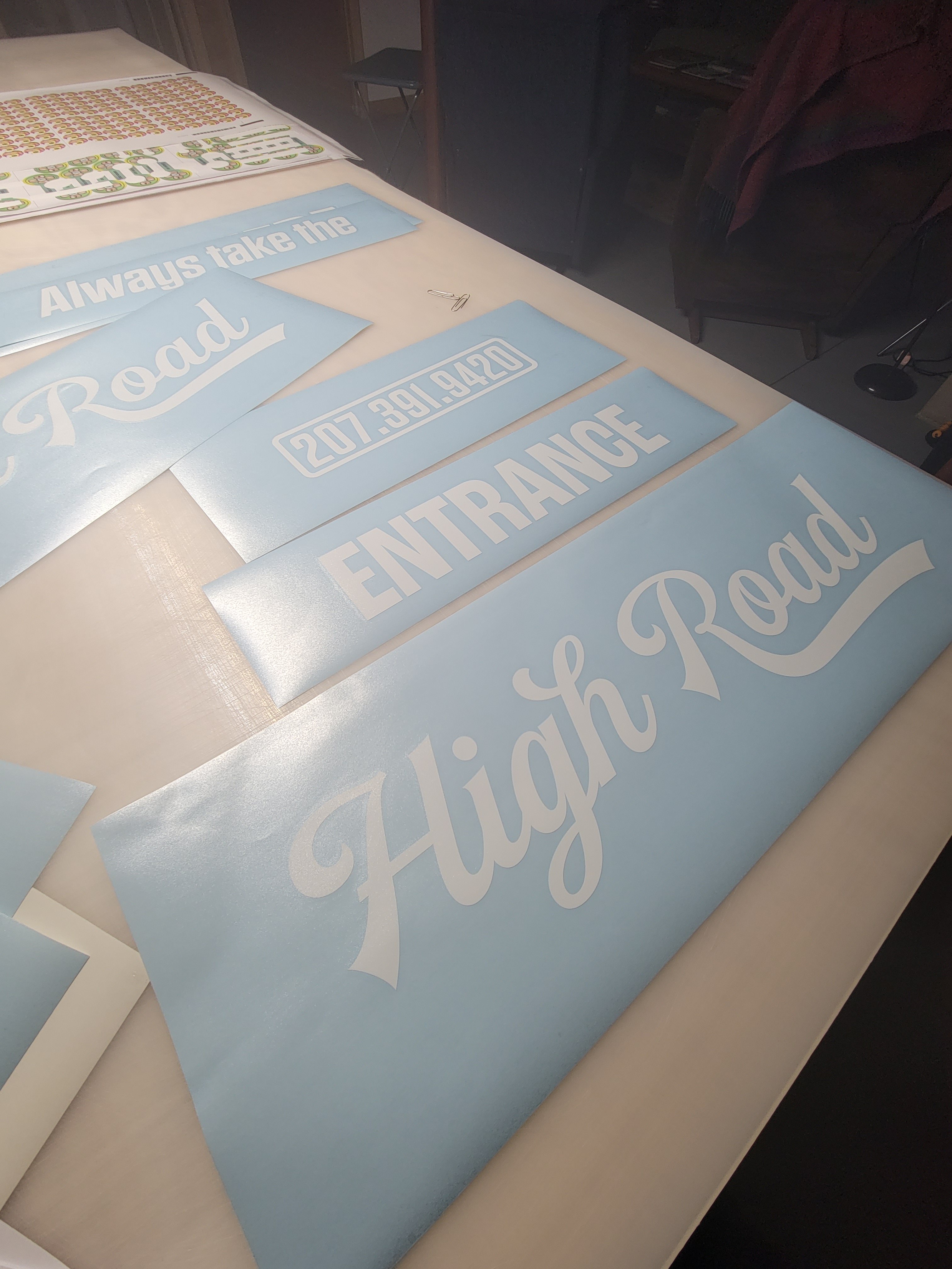

Well they wanted all the pieces cut individually, they are doing the application of these themselves or they have someone that is doing it for them.
These are all masked with a clear transfer tape, just wondering what is the best way to mail these without the transfer tape coming off the backing paper. (tried to deliver these yesterday in the snow, but they failed to let me know they'd be closed. wasted an hour of driving for nothing.)
