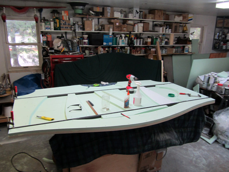

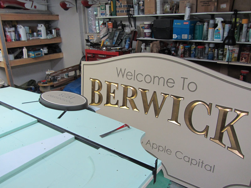

Well... big for me. Here are a few pics of the glue up of a 54" x 96" double sider. I glued and screwed the spacer foam and let it cure up then the front face was glued on. This cut the workload during glue-up and made all those parts sit still instead of squirming all over with wet glue on them. I've never used this approach before with the screws but it works a treat. The top (face) was clamped around the edges and I piled lots of weight in the middle to press it all down. The urethane glue can push the faces apart as it cures so you need lots of weight.

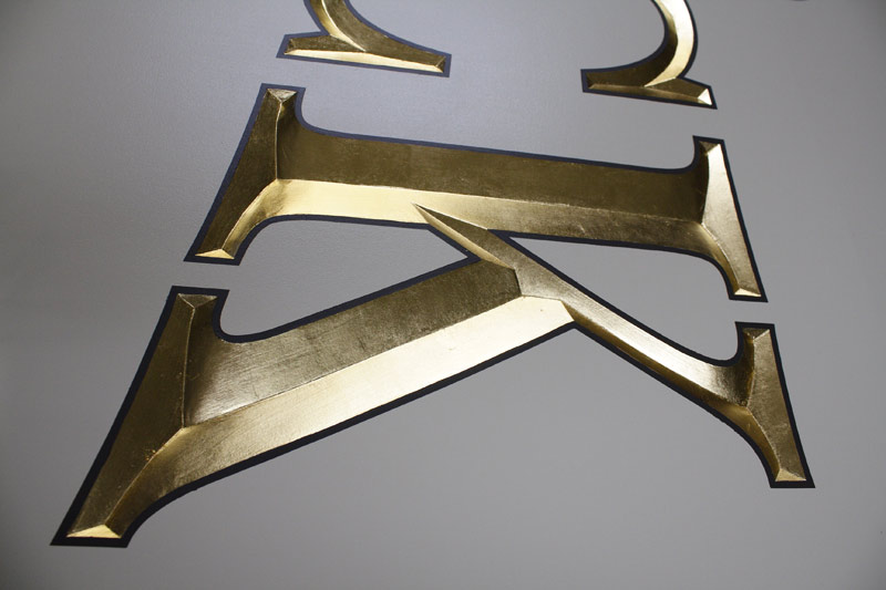

Added a detail of the gilded lettering. The larger ones are about 18" tall. Took 4 books of gold.

The long black things are 1" square steel tubes. The sign is 3.5" thick which is pretty strong in itself.

3-1/2" thick? Is the spacer foam 1" like the steel?

The spacer foam is 1" scraps from the cutting out of the sign panels. The front face is 1.5" and the back face is 1". I used to route grooves for the steel frame but this is a lot easier and faster... Stronger too.

Time travel? You mean my primitive methods I presume. I do have a lot of experience with archaic technology. You'd love my wooden scroll saw... (you can just make it out in the third pic.)

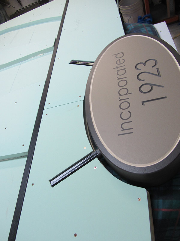

Archaic? Foot powered or power? I saw some guys doing stone inlay with foot powered saws, it was awesome wort too. Do you use anything else to bond the steel to the foam for the address portion? How are you carving your letters, it doesn't look like you have a router? Very nice sign. I just did a couple of 3'x12' and laid them up to mdo, way too much work.

My scroll saw is based on a foot powered one but uses an old 1/4 hp washing machine motor. I made the saw about 30 years ago out of oak and odds and ends. The arms pivot on an old rocker shaft from an MG.
The small oval sign is trapped by the angle of the square tubes embedded in it. It does not require glue to hold it in, although, urethane glue sticks to steel very well.
The lettering was carved with chisels and a box cutter.
