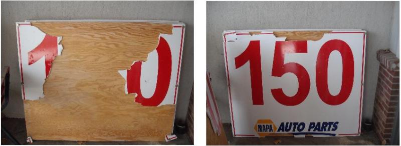

I have a golf course that I supplied marker signs for their driving range - this signs gets slammed by golf balls everyday - after asking around I decided to use 1/2" white PVC the sign size is 4'x4' with regular vinyl copy
i used PVC because it is white thru & thru
the one closest to the golfers, the one that gets hit the most by the golf balls is getting pretty bad - the other are not as bad because of course they are further away.......I need to change that particular one - any suggestions on a material that would take massive abuse daily? - Some have said steel, but I still need to finish the steel to make it white and am worried that the finish would not last a day.......HELP!

OK so I said I would post pics of the damaged signs......Yes i know....what was I thinking - I am going to change the signs with polycarbonite unless any new ideas come about......:covereyes:
