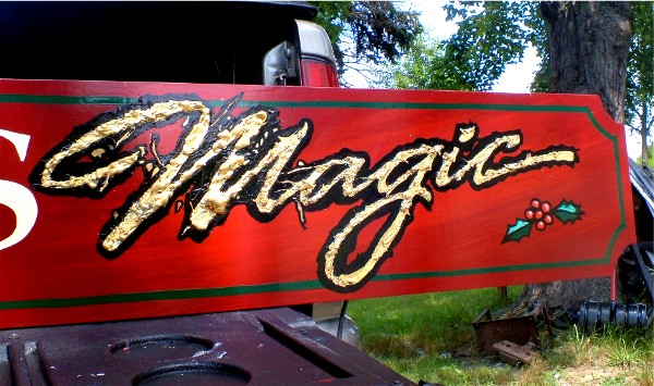

I have yet to see any lettering done with gorilla glue that looked like it was worth bothering with. You must be able to find a better use for gold. Do you have any pics of lettering done this way that look good? It always looks like gilded Cheetos to me. I guess I'm being negative....sorry.

What? You don't like shiny Cheetos?
(I agree, it does look like that)
After my last experiment with it I have decided it's not worth it.

I think the Magic sign looks wyld! I love signs made using different approaches....(car parts, body parts, old junk, etc...). They still need to have a good layout and be balanced though.
From what I've learned, the GG technique is not necessarily for signs to go on a bank (elegant, scrolly, formal, whatever...)...but is used for a funner, splashy look. I've seen it used on pinstripe panels and loved it!
I would be interested in hearing what the cheap Thai gold was like.
i;ve got to agree..everytime i see this topic i cringe, i have seen some of the best in the industry experiment with this technique and it still looks like doo doo.
in my opinion it doesnt look like a gilded cheetoh but a gilded turd and even if you gild a turd, well it's still a turd.
