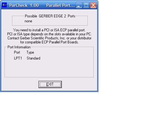

Tony- I did "run as", and have attached a SS of the window I got.
edit:
ok, there it is.

From the dialog I say that the port is NOT an ECP port. There use to be plugin boards you could buy but someone on here would have to speack for that. I have no idea about who's interfaces (plugin card) worked and which ones did not.
Why the ECP port - because we need the data rate to feed the Edge or it will starve and pause at the end of each "page" (11.84 x 12")

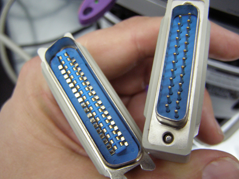

Just out of curiosity and it's going to come from left field, but you didn't bend/break a pin when moving the cable from one to the other? Seen bent pins cause all kinds of weird problems before. Sometimes the pin breaks off, sometimes it bends upwards and grounds out, sometimes it'll bend into another pin and go into the same hole. Something to check for as a last resort.
Unsure of the connector the edge uses, but some parallel devices use a 25 pin male->25 pin male connector, others use that really big flakey lookin female connector.
