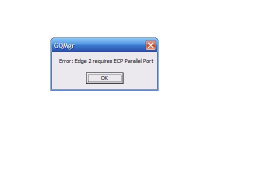

GQMgr: error: edgeII requires ECP parallel port...?
DeVries Signs

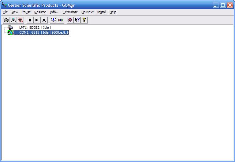

I removed the cable from my EdgeII and used it on my Edge Classic to test it....now I am getting an error when trying to use my EdgeII again. Cable's connected to the same LPT1 port as always!
Anyone know what I need to do to resolve this?

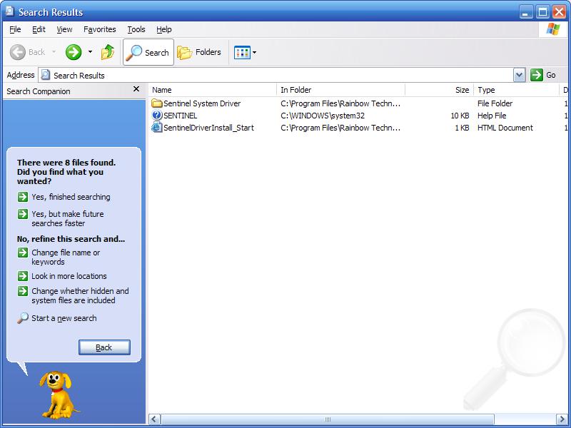

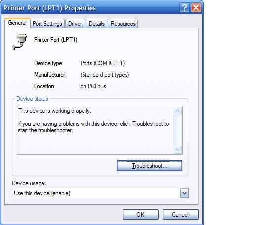

DeVries Signs
Some pics.

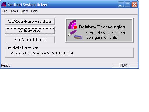

I used to have this problems sometimes. I would actually have to open the sentinel driver software and reset it before I could get it working again. You are only going to find the ECP port status change in the bios. I've never seen a bios that did not have the option. From old to new, if the port is there, it's in the bios. I just built a brand new one last week and it was there.

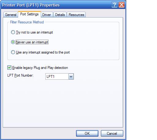

In your pics. Why is it set to never use interrupt. If I remember right it should be try not to use interrupt,, that is unless gerber sets it otherwise...
Also, newer machines have it set to high speed usage. I might guess that your hardware may be sensitive to high speed ports usage.
You can observe this port under the system properties. Or you can add it under the system if it is not there.. Check to se if the driver is ok there as well.

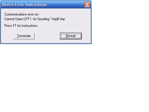

However, in the end,, the error code says it cannot open the port. I would start there and figure out why the port is locked. Maybe it is already in use? Or there is a job in the que?

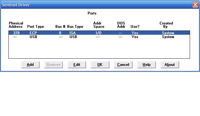

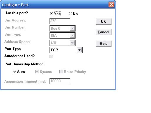

The sentinel driver should be set to "No" for all shown ports that are not where the security key is located and "Yes" for where it is located.

Ok..I configured the "port type" to ECP, rebooted the PC, and still get the same error code when attempting to print on the edgeII...
Fred Weiss
Merchant Member
You need to change the ECP port to "No" in the Sentinel driver. Only the port that houses your security dongle should be marked as "Yes".

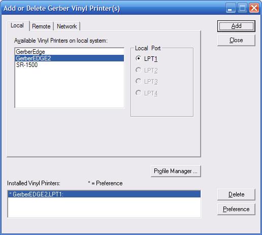

Try going into the GSP Tray > Install Vinyl Printer and remove any installed Edge printers ... then reinstall the Edge 2. When you do it will display any suitable port that it sees. If there is more than one then you have a problem. If there is just one, select it and install the Edge to it.
DeVries Signs
Yeah, I tried that yesterday...and just did it now again to make sure. I deleted the Edge II, closed out, then "added" the Edge II (see attached). Same error code is thrown...
