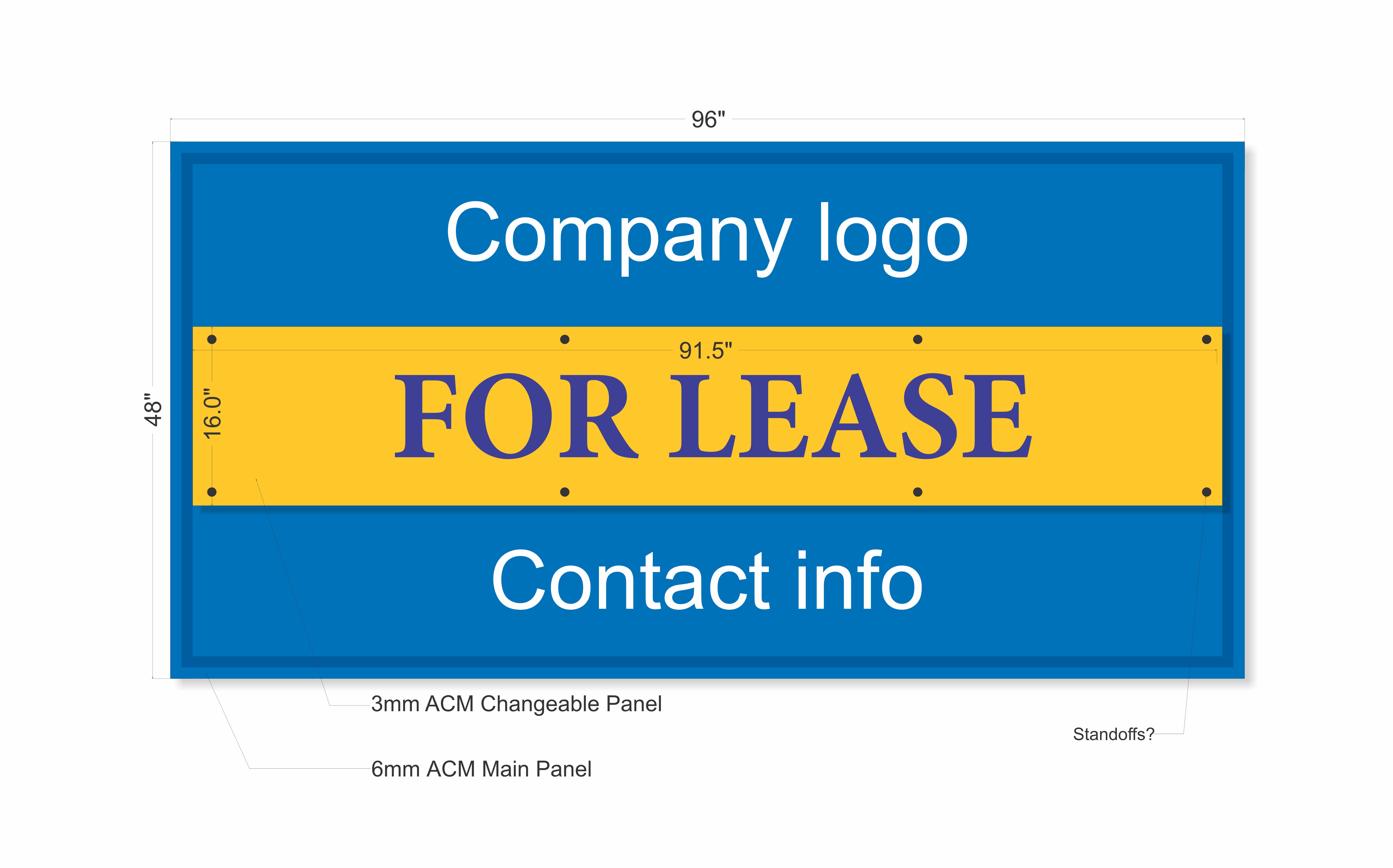

We've got a few of these to build for a customer, who changes their own inserts. We're making 6-ish or so and they don't have very much turnover at all, so they won't be changed often by any means.
I'm having a hard time deciding what to use to attach the changeable "banner" part - I was thinking standoffs so customer could just spin the caps off, remove old insert and install new sign and put caps back, but I'm not sure how that would look/work on the backside of the main panel.
These will be single sided for the most part, and may or may not have access to the backsides once they install them.
Any thoughts or suggestions?
Pic w/ rough mockup attached.

I've done it with locktite and counter sink screws on a multitenant structure that the landlord was tired of different shades of white panels. Standoffs come in all flavors ya know, go for one with a threaded barrel, thread a carriage or elevator bolt from the back side of the substrate through the barrel, and use the female caps to go right on the end of the bolt after the acm is put on. Ideally the square shank on the bolt will keep it from free spinning.

Good ideas, thanks. Any concerns w/ stainless steel standoffs if they're going to be in contact with ACM and/or another bolt? Maybe safer to just go with aluminum standoffs...... ?

Velcro? or if that's not strong/vandal proof enough duralock?
Ehhh....I'd be nervous with just velcro. They don't have a lot of vacancies so changeovers will be pretty rare. I also have to keep in mind what it will look like when the insert is removed.
Sorry, forgot to mention, the idea is that the main back panel reads "Fully leased" like in the mockup, and an overlay is only installed when there is a vacancy.

Close to a rivnut, but rivnuts expand when installed. I'd recommend them over threaded inserts in this situation as the threaded inserts are standard thread, making removal possibly a pain with resetting the inserts when the bolt sticks in them.

Thanks Scott, I like this idea. Just found out most of the signs won't have an overlay sign at first so standoffs won't work. (Don't want a bunch of threads sticking out of the signs, will look ugly)
We're going to CNC the overlay panels so we can make sure hole placement is precise enough that customer shouldn't have issues threading a bolt into the main panel.
