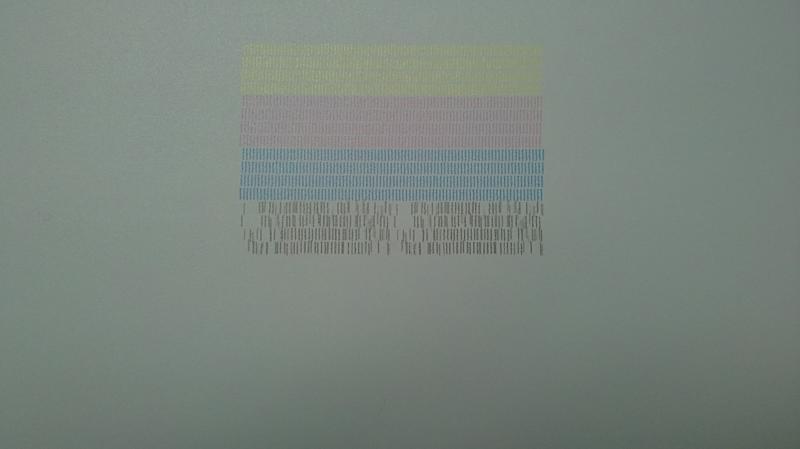

my printer is an roland sp-300, tried the damper fild with cleaning fluid and its not better. multiple lines are still missing on the black test print and the others are bad. the result on black prints are fuzy edges and color not pure, black is gettting greener. Ive changed the cap top, damper, wiper...

Test print is black but greenish when printing, tried multiple profile and almost all the same greenish result, and the greys are so bad, always had issues with gray but now there very green.

That black head does look quite bad, which is a possible reason for the green tint as you are not getting full black as it should from that head.
If doing head soaks had not helped and running several cleanings with the cleaning solution you could try as a last resort to use a clean cleaning swab and soak with solution. Not sure the process you go through to move the heads for manual cleaning, but move them so you can push the cleaning swab up under that black head. What this can do is force some cleaning solition up into the head and hopefully clear some blockage. Never rub under the head just press up and release and do it several times. Then do a couple cleaning cycles and try a test print. If any nozzles come back do it again. If nothing changes then you may need a new head. If it had any head strikes, that may be the cause of the missing and deflecting nozzles.

last week I ran out of magenta ink during print so I went to see a guy I know in the next town who own's a sign shop so I can borrow him a magenta cartridge ink. Well guess what this was not the original ink, same cartridge but reffil. Changed back with max inks and back to black:)
