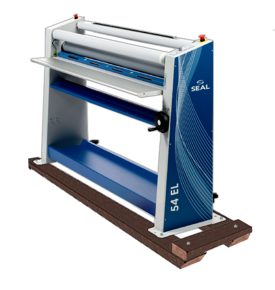

Take off casters, use holes in feet to bolt on 2x4 skids to the bottom, bevel the leading edge of the skids, bolt on a cross member, use cross member to pull with a come-a-long up the stairs.
If the stars are susceptible to damage, you can cover the bottom on the skids with carpet scraps or something similar to protect the steps.
Goes up the stairs like a sled!
