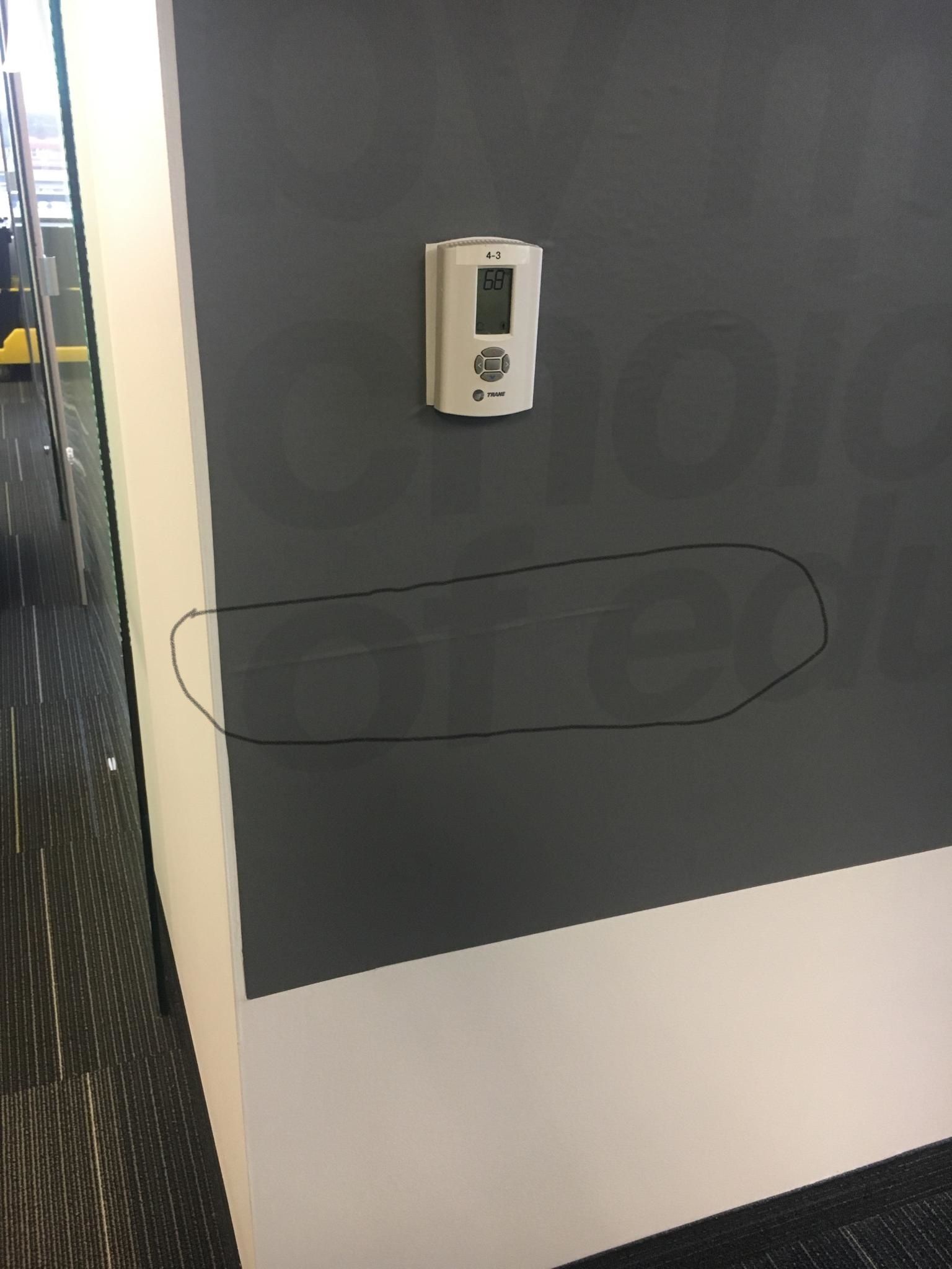

Ok My guy reported back that with heat and pressure it did not stay stuck down. He lifted it up and tried some sort of spray adhesive. Its stuck down but he says there is sort of a shadow.

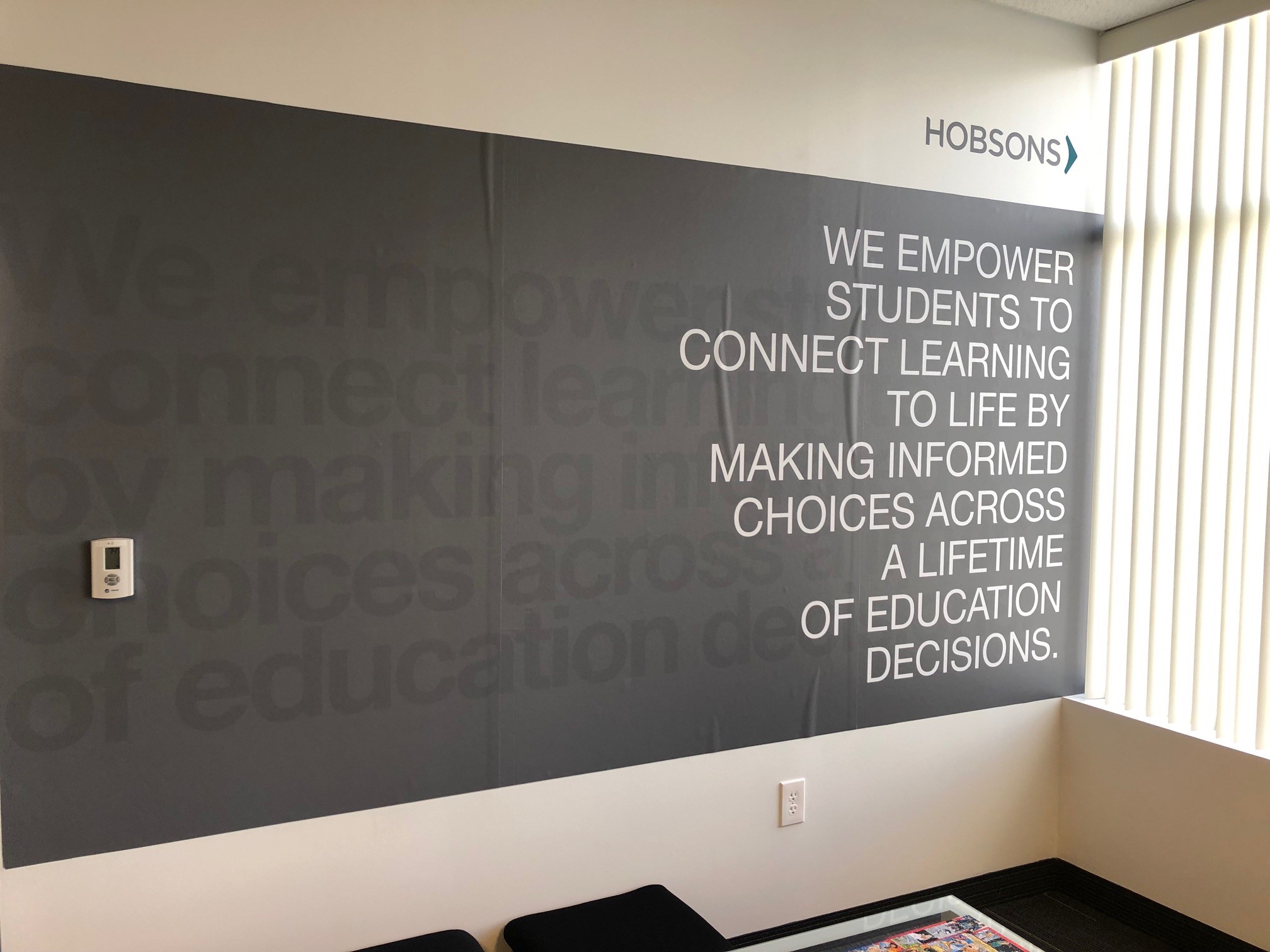

Ok more problems. Again I didn't print these but the same wall has issues. It appears to be mostly the edges someone told my friend who is installed them there is some sort of magic "adhesive" that can stick them back down. Also he is heading to this office right now and just asked me if there is something he can find in a store to fix it.

Is it possible he didn't apply it right? Like did the vinyl try to winkle and he worked it in and those areas had too my tension and are now lifting?
TimToad
What a mess. It really looks like they rolled them liner out AND the wall surface is repelling against the vinyl. What kind of experience level is your friend at?
I'm not sure there is much to be done to make the vinyl lose its memory of being both rolled wrong and installed improperly.
Looks as though he was too gentle while squeegeeing it all down. Your first picture showed a bubbling effect everywhere. Is that drywall or wall paper underneath ??

I've always rolled my murals liner outside without any problem in the last 8 years. I've tried mojave in the past and did not like it. If your friend have stick and unstick the vinyl on the wall during the installation, the glue have tendency to go off the vinyl. But I never saw that kind of problem. It look like there was too much material at the same place (wrong squeegee technique). I would try to peel off from the right side, heat it a little and put it back.
In the first picture, you can definitely see that the installer don't have a proper training/experience just by see how the cut work have been made around the thermostat. You can see a little ''finger'' in the corner because the material has not been stretched and apply properly. And this probably caused the other ''tunel'' on the bottom.
With the bubbles metionned by Gino, I would definitely say it's a wrong installation. If not, maybe the paint is still outgassing and/or wrong paint.

I installed a phototex mural in my own house, and I had similar problems. The wall was painted plaster and on top it holding a lot of moisture, its pretty warped. AND, I overestimated my ability to install 9ft by 52" panels, vertically mounted, by myself. I think there is a variety of errors here, and the only fix is to reprint. I'd probably use an air-release vinyl with lamination and bring a helper.
Also, I agree the cutout around the thermometer looks amateur.

Yes the the graphics were delivered liner out. My friend does not have a huge experience installing wall material.
Yes this is new rushed construction. Not sure how long the paint was allowed to out gas but pretty sure it was at most 2 weeks but maybe more like a week.

I'd agree, I would think reprint is the only option.....
PS, I just looked at the thermostat pic again..... Did he not remove the thermostat to install?!?!!
