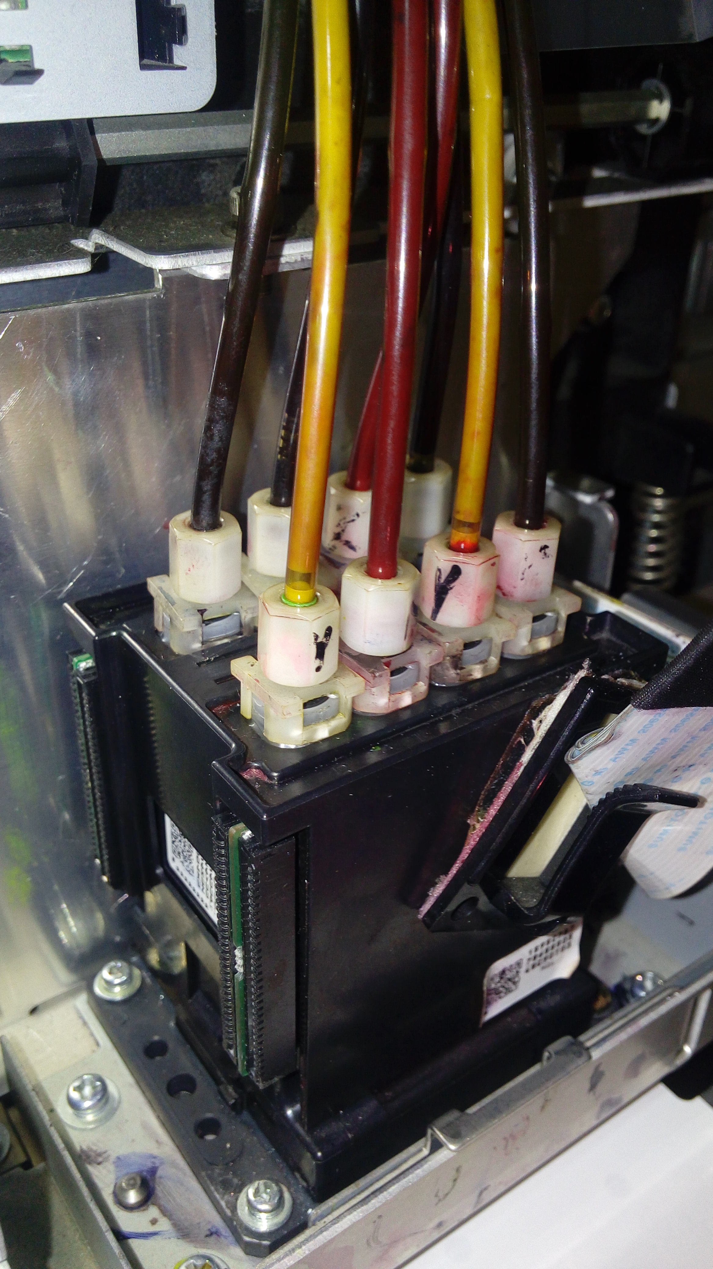

Hi. I know little English. google helps in this. I installed a new head and a new damper on the mutoh 1924wx machine, but everything is not normal. there is air in all pipes. I checked everything but there is no solution. When I inkcharge everything is fine, but after 5 minutes there is air in the pipes.
It's not clear in the picture but it's all air
i changed all pipes and inlets for air leak.
Sorry for my english google translate helps this

Use original dampers, original station, make sure there is no air leak from o ring or failure parts. You will be back on any time. Aftermarket dampers will not work.
