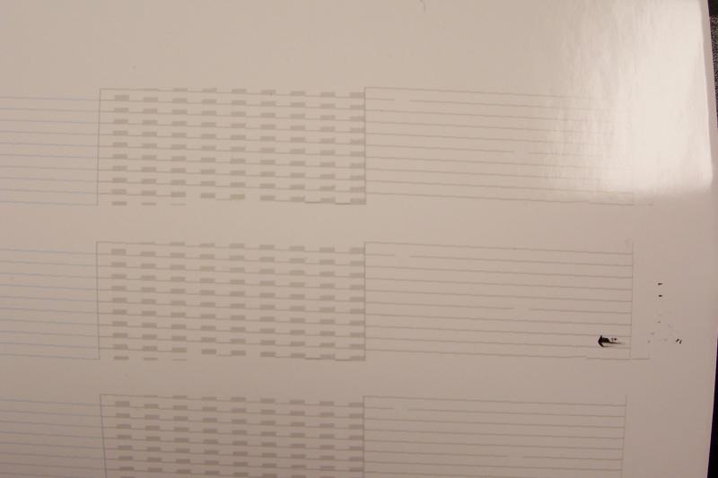

It's been a while since I have posted- so hello, My name is Glenn and I am in Macclenny, FL just outside of Jacksonville. I was hoping someone has seen a nozzle check like the attached pattern and can give me some insight. I have soaked the head, completed 2 heavy cleanings and replaced my wiper... any thoughts?

Are you talking about the distorted nozzle test with the additional blocks?
Bad head board or cable.
swap cables to determine the issue.
heyskull
I rekon that's an electrical problem.
Not a blocked head as you can see it is still printing the test pattern.
Something is touching and making it overprint.
Double check your cables and then I would be thinking about a new head!
How old is the machine?
