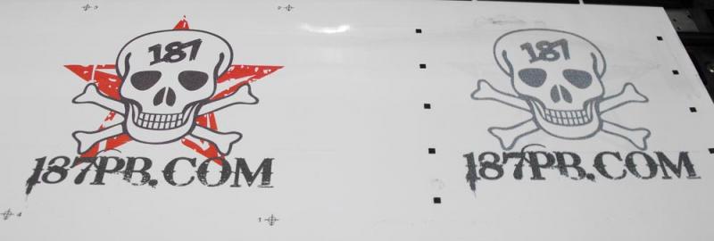

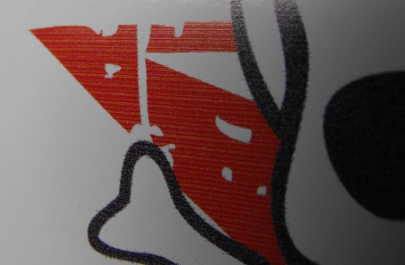

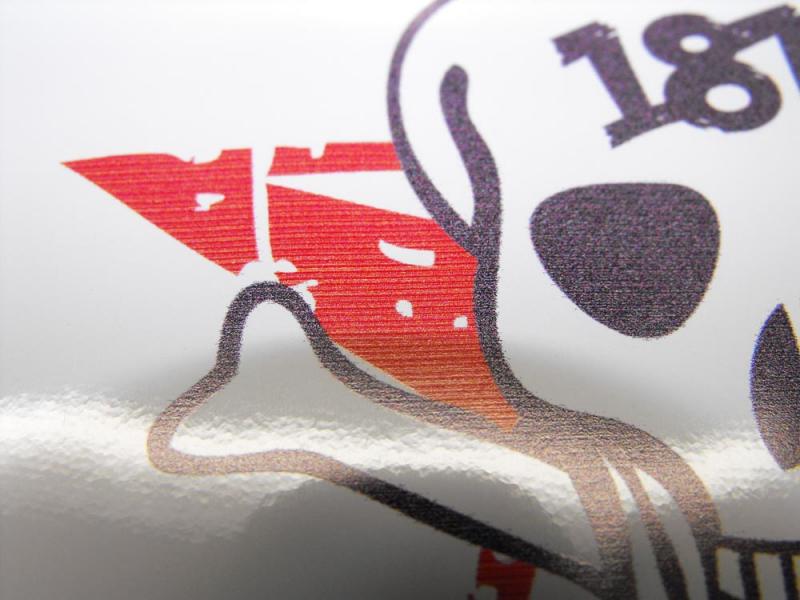

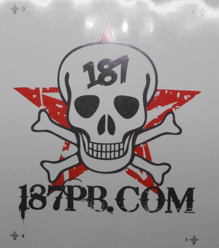

Now a new set of questions. I am posting a few pictures because I need help fine tuning my print. I'm getting some banding and fuzzy edges, wondering if you guys have some pointers.
Print on the right is before the new hose, the left is after.
