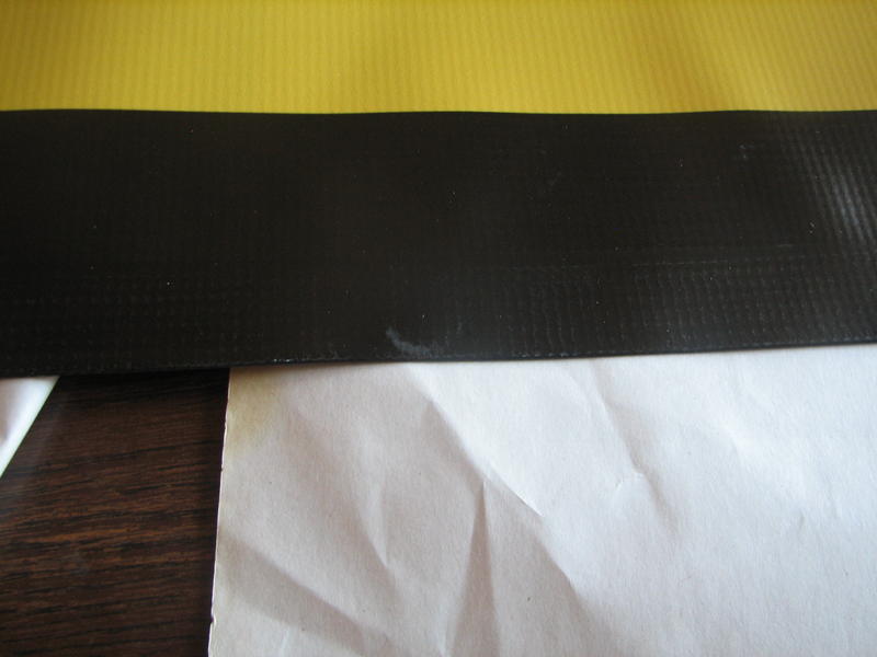

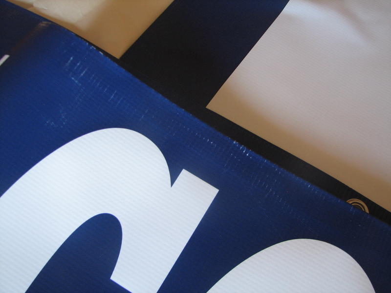

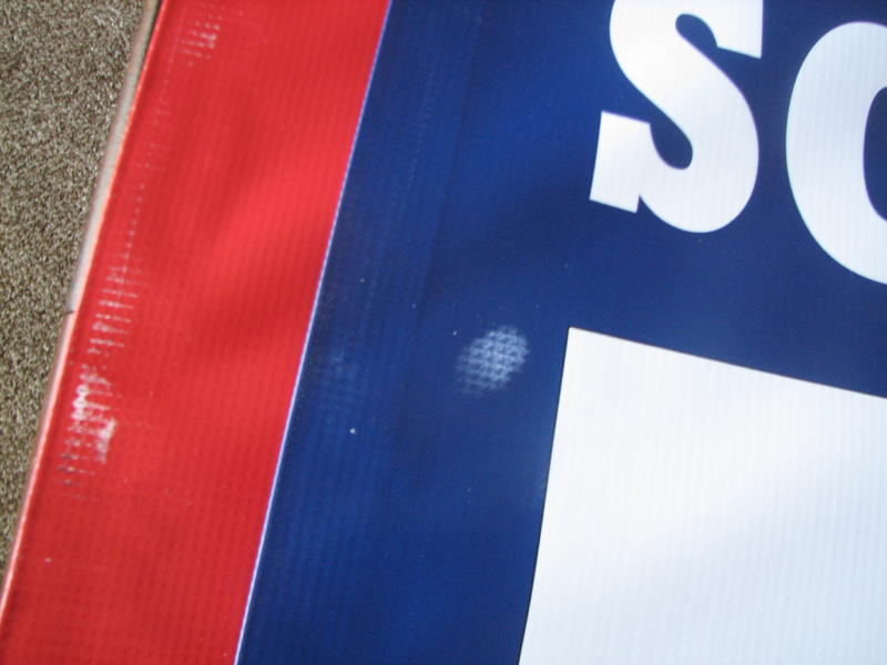

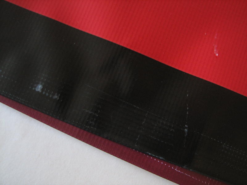

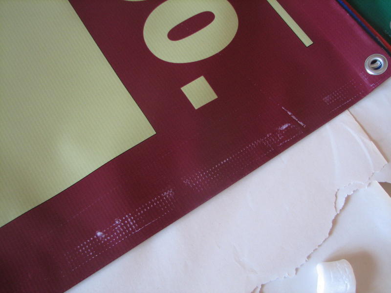

Yes, I understand it is a reflection on me. I have sent them photos...I've attached a few here for you to see. I guess I need to ask about lamination too. I just hope the company will re-do them correctly.

Good luck getting them to do them over. I understand they are not in perfect condition, but did you pay top buck to assure you would not have this happen ??
People's perspective on things change drastically, when something minute is pointed out and held to a higher level then intended. It looks like sloppy handling as you said while hemming or grommeting. If these were going outside on a fence, selling real estate, they'd be fine. Using them how you intend, sounds like the wrong materials were used and some carelessness happened, but nothing beyond normalcy.

I wouldn't except anything but having them do them over again. Why shouldn't they be held to the same standards everybody else is. Just because it's cheap doens't mean you can throw it around and give a ****ty finished product. I shouldn't have to say do I need to pay more so these don't get scratched during production.
Also it doesn't look like a shipping issue to me. It looks like they put it through a hemming machine and it scratched the crap out of the prints.

Looks like squeegee marks to me. My guess that it happened when they were hemming them. Very easy to scratch banners even with felt squeegee. Mostly happens when it was not left alone to properly dry.
I think you might have problem to get them re-done, but i would try anyways since its not right.

Common sense, let the ink dry before hemming banners... That should have been caught before they were shipped to you, whoever did the hemming had to see that. If I sent something out that looked like that I'd be (justifiably) looking for a new job.

They have agreed to re-do them and said they had rushed them since we had some things that slowed things down. As for them being cheap, I was given a budget to work with. And I asked this company if they had done conference banners before which they had so I let them decide what materials to use since I hadn't done them before and definitely had never ordered anything printed. They want to re-do and ship..they ship nationwide and claim they never had a problem like this before. I could drive to get them...it's about a 3-3.5 hour drive and have a car that gets good mileage.
I agree that I think the damage occurred when they were hemmed and grommetted. I am debating about hemming them myself with double-sided tape which again is something I have never attempted but watching youtube videos it looks doable. I have applied grommets with a kit with a punch and die set and used my hammer. Worked for sides were I needed to add more but worried I might have problems at the corners.

most of that damage to me looked like its from 1 the banners being printed on a solvent machine 2 the banners were handled and stacked and hemmed way before they had time to gas. I would be worried about them RUSHING them for you lol. good luck.
