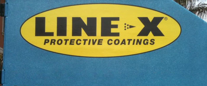

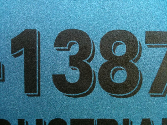

LINE-X
Graphics can be applied to LINE-X, see below. However, these do not have the polyaspartic sprayed on them. So, it can be done, but I'm interested in creating them myself.
