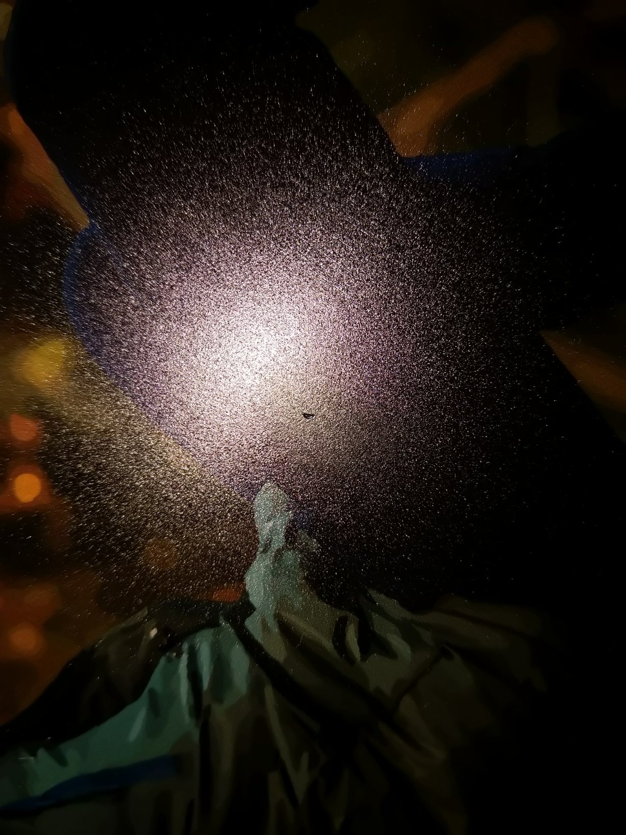

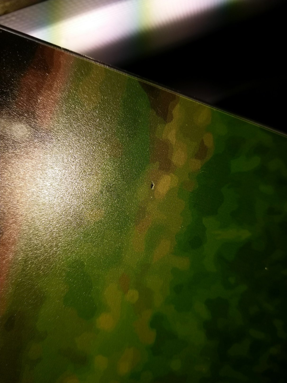

i print a photo on transparant acrylic / plexi.
now when i am ready printing i can see through some verry small holes when i hold it before a light. so i think it might be dust orso . but when i print over it again teh holes stay . so what is the problem there? i have an roland lef2 200..

ok now comes the wierd part i cleanet acryl good before printing . now i did the same photo only a little bit smaller . and there was the spot again on the exact same place in the photo. now its only the one spot so cleaning acrylic might go a bit better but the same spot on the same place what doe that say ? not much to see on the image itself
How about a totally different file ?? Are you also using the correct profile ??
