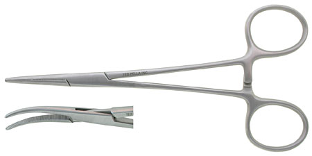

After some playing around and back-and-forth with my tech on the phone, we targeted the slider board as the likely culprit, so I have a new slider board and ribbon cables coming tomorrow. In the meantime, the pumps can't cycle because the heads aren't functional. My tech suggested filling the capping station with cleaning solution so that the heads can soak, but as it turns out I apparently have a bad pump too, because the solution won't sit in the capping station. It just drains out. How in the world am I going to keep the machine from freezing up with ink in the heads/lines/whatever, if I'm not going to have the parts until tomorrow?
sfr table hockey
I don't have a Mimaki but my old roland sits for a week and as long as I flush the drain lines before use, it tends to be ok.
The reason your caps are not holding the ink is due to the pump and where the rollers happen to be sitting. Some time they will stop when they are pinching the drain line and then no air leek and other times it may be just after compressing the drain line.
Drain lines tend to be the main reason for a pump issue and when you think about it, if there is a dried up blob of ink stuck un them the pump won't be able to create a draw and thus your heads can't recharge. Clear the drain lines before you use it next time and you should be fine.
Or what he just said...

color_zone
+1 for the clamp idea. I checked with our service manager and he had a box of these. No shop should be without 'em. They work great for clamping the lines and I'm hopeful that I can stumble through this until I get my parts in.
