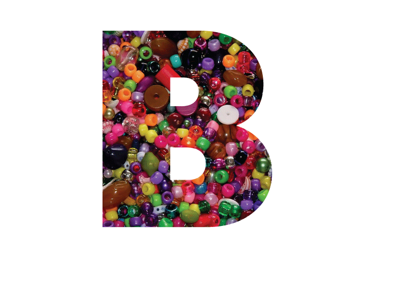

Can't you just powerclip it into the text? Or am I misunderstanding what you are asking?

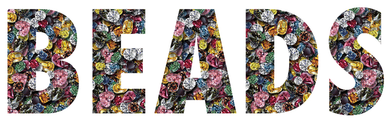

If what you are seeking is to maintain the scale of the beads while retaining some semblance of resolution, then the best way to go at it is to make a seamless tile of the content. So yes, each bead is placed once in a single tile and then the tile is used to fill whatever size you need for the produced print.
The time needed from the point where you have the beads separated from any background would be 15 to 20 minutes.
Here is a low rez version of a similar tile I made a while back. If you want the high rez version, I can put it up at Express Clipart.

Oh, I see now. You want something very different than all we have posted? You wanted the beads to follow the outline of the letter?
I retract my earlier post then :) That clearly wasn't what you were looking for.
Bigdawg
Just Me
Clipping wouldn't work IMHO... the edges aren't clipped off... the pieces are fit in to the area to make the shape with no straight cut edge. I think Pat's got it right...
