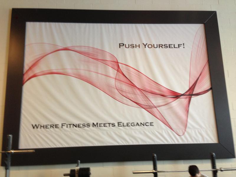

How can I stretch out banner better?
copythat
Client's construction crew said that I can't use spring system, cause black borders wouldn't be able to fit with any budge. Is there anything else I can do to even it our better?
TIA

How solid is that black border frame up there now?
Could you use the backside to stretch and attach your banner on?
Maybe use some thin aluminum flat bar riveted to the black frame with the banner sandwich'd inbetween.

SightLine
You say not springs but the company that makes banner springs, Lind, does have an aluminum frame they also offer to cover the springs which looks very close to the black frame you show. I have used a bunch of their springs before and they do work great. I have not tried their frame though. Realistically it is just a 2 piece thin aluminum frame, install the back part behind the springs then slip the cover part over it once you install the banner.

How solid is that black border frame up there now? Solid
Could you use the backside to stretch and attach your banner on? I'll check & it makes sense. Originally I offered to print on vinyl, but it would have been too many layers for their liking. 17' w x 12' h
Maybe use some thin aluminum flat bar riveted to the black frame with the banner sandwich'd inbetween. This sounds like a plan.

We have two gyms where we print some nice size messages and inspirational graphics of about 12' x 15'. Their old vendor did it on PVC and they was always warping or bowing. We did it on over-sized 1/8" aluminum composite. From a few feet away, it's almost impossible to see the seams. For a frame, we just fake a frame in our artwork. They always supply the files for the sign portion and they are top notch files. Always turns out nice.

I know that's up already... but I aways have this observation about artwork and the simplest solution, and how people with wide format printers think just printing everything is the best way to go about this. When I look at that wall, what I see is that there should be a large white surface under the frame. Whether it's a couple of panels of dibond, aluminum, or just a flat painted wall. Breaking down the artwork to a few feet of cut vinyl letters, and then with the swirly print done on clear, and contour cut near the edge of the artwork. In this case, that part could have been done (cut) by hand in a few minutes.
No spring tensioning systems, complicated framing systems, no wrinkles. Installed in under an hour.

is that banner cut to fit inside of the black frame? You didn't remove the frame to install the banner did you?
Edit: After looking at your picture again, I think you can easily get the wrinkles out on top......but the bottom looks like most of the wrinkles are caused by the seam job. (but maybe).
Should have outsourced to someone that could print one piece. A flex frame would be the ticket.
kanvas
From what I can see. All the looseness is in the width of the fabric. The wrinkles show that it is pulled over further to the left than the right and that its not pulled enough across. The wrinkles at the bottom are caused by the seam being much tighter that the rest of the fabric.
I would suggest that if you staple the fabric to the frame. That you do not do it with the frame flat on the floor. Stand the frame up and let gravity help you stretch the fabric in the height. Start in the middle at the top and bottom Stretch between those two points. Go to the sides and do the same thing. Work the diamond pattern to the corners. Like you would stretching canvas for a painting. You might have a problem with stretching the seam.

Maybe there were external factors I'm not seeing there but a couple of things jump out. First of all WHY DID YOU SEAM A 12' x 17' BANNER THAT HAD TO BE STRETCHED? That will never work. The individual panels flex enough differently and the overlapped seams are twice as thick so there's no good way to get nice even tension across them. That's really apparent in the bottom couple of feet. You could have gotten a wholesaler to print it in only one panel. Sure, it MIGHT have taken more than three days.....I promise you whoever gets to redo the job will get more than that. Second....that stretch job is really bad. Did you stretch from the center TBLR out to the corners evenly? I looks like you started on on side and stretched it across to the other. Just curious...how is it affixed to the wall? DId you staple it in or just screw through the grommets.
