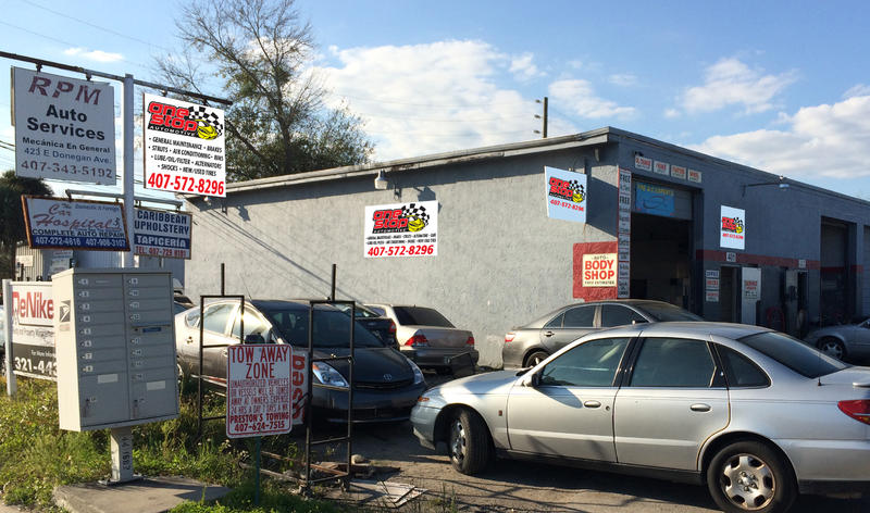

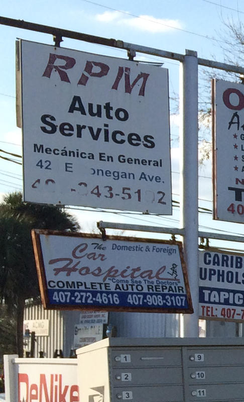

This customer has a wooden sign that would like to convert to aluminum and cut vinyl. Any suggestions on sheet thickness and how to build a frame for it? Newbie here :(
(RPM sign below) trying to do this right and cost effective so I can get the other business with same crappy signs

OK, I'll be the contrarian.
First I can't tell how that sign is hung on the top, it looks like two welded tabs on the arm
and then a tab on the top of the sign? Or is it swinging?
If it's solid mounted I would go with the 10mm ACM and put a couple solid fasteners on the side/bottom too.
But if it swinging I would use something heavy like 3/4" MDO painted or with 040 aluminum faces.
And thru bolted sign hangers. And let it swing. This is assuming the arm and mounts are solid.
A swinging sign should be allowed to move as intended, and it should be heavy enough to not flap around in the wind.

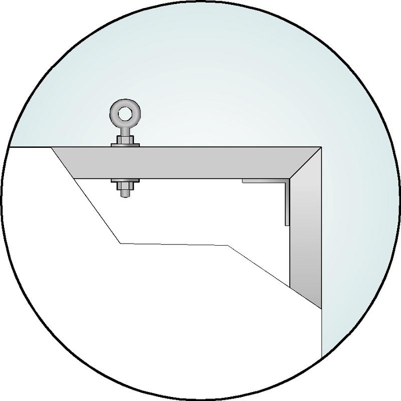

I frequently use 1-inch aluminum square tube for an internal frame. I then skin it with panels front and back using Lord adhesive. I like .063" aluminum for the skins, but .080" would add some weight if desired. Aluminum composite faces could be a cheaper version.
The advantage to this construction is there are no fasteners through the faces. It's a clean look.
A small amount of adhesive on the inner nut and washer will make the eye bolt permanent. The gussets on the inside corners are cut sections of aluminum angle, and can be screwed and glued, or just glued.
I can make a sign like this very quickly. It can be welded together, but there's no need unless time is a huge issue, in which case you can weld the corners and use VHB to adhere the skins.
I use unfinished aluminum, then prime and paint the entire thing.
I use no more than one link to hang, minimizing side to side movement.
An additional frame of square, or rectangular, tube can be added to the outside perimeter to hide edges. At added expense, of course.

Indeed is a 4x4 sign, double sided, it is currently on a square pole. It does not swing (maybe due to all the rust, lol).
Can anyone one post a picture or a link for the required hanging hardware for this? I see a bunch of straps and hardware for round poles only
Thanks
