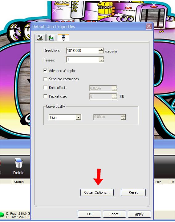

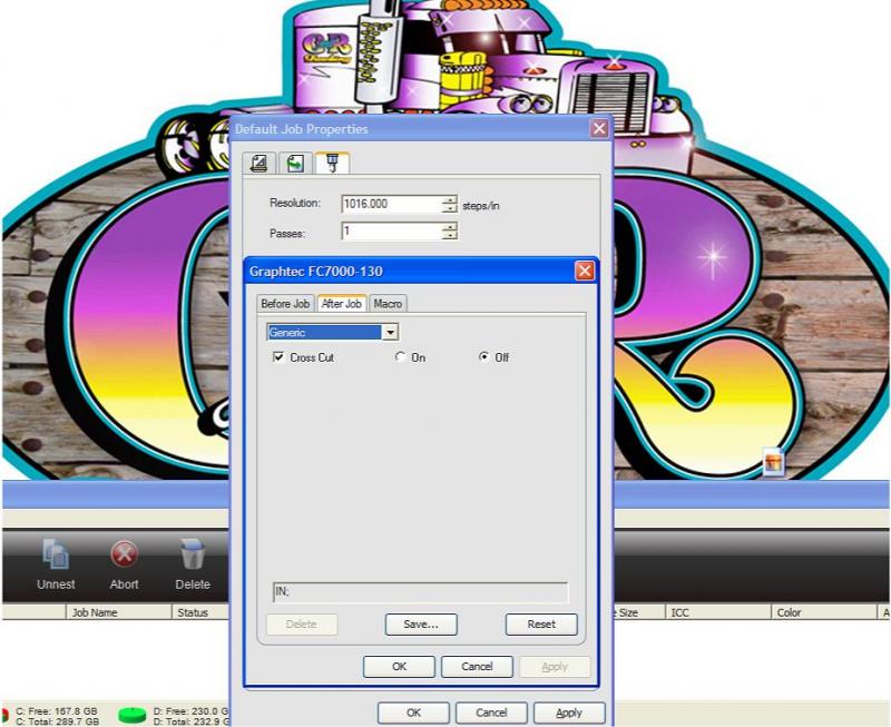

Got yah..... here is your answer LOL in PM go to Graphtec properties .here is a pic,as you see i have mine turned off.Hope that helped:peace!::peace!:

after you open default job properties at the bottom there is a button called cutter options (see Pic below) open that up and go to after job.

In Production Manager (PM) Right click on your plotter and go to default properties .
