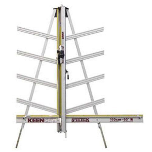

Keencut SteelTrak Vertical Substrate Cutters
I have one of these. Has twin roller blades that cut aluminum composite panel like butter.
Well worth the investment. Mine is freestanding, but you can also do wall mount.
Cuts PVC, coroplast, foambaord - anything you can cut with a knife. Also scores acrylic and glass.

recently we got a Keencut SteelTrak Vertical Substrate Cutters from Grimco, the rep was Jason Pfeffer got a great price and it has been very helpful
