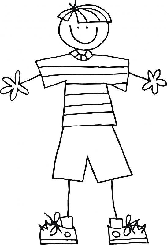

I am trying to make the lines wider on the stick people I just bought but am not having any luck. I have tried to increase the stroke size but it's still not cutting thicker. Any ideas? THANKS!

Are you sure the outline is the same color as the original? because if its even just a shade different your cutting software may be seeing two different colors and cutting only one at a time. Also weld the outlined stroke to the original

petepaz
the cutting problem is if you cut a line that is all it is is a line
you have to make boxes or outlines around the strokes
if you make a stroke an outline and cut it, it is still a line no matter how thick you make the stroke
you need to have cut lines on the outside of the stroke
the stroke makes the line thicker but the cut still only goes through the center of that line
i hope this makes sense
MVIP
convert to .bmp take .bmp into flexi or corel then trace. voila two lines.
